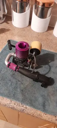

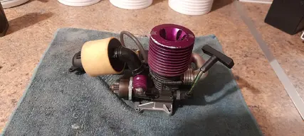

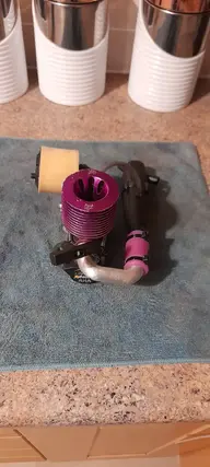

Savage ready 25 engine fully serviced and did i little repinching while i was at it . Why do brushless rc ers not want to do this i mean just look at it its freaking beautiful šŸ˜ bring back nitro come on my local hobbie shop rennicks modle tune get down and buy a nitro to and of my friends
Nice work mate glad she’s all sorted
What method/tools did you use to re-pinch it?
I used a 19mm collar clamp and 22 mm brass pipe cut to a 5.5mm thick peice for inside the collar then drop in the cylinder and pinch a little at a time while incerting the piston and when i got to a good pinch point a heat and quench
