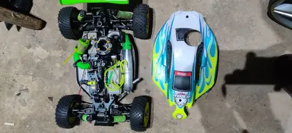

I bought this around 3 years ago had it running. Since then it's been sitting for 3 years so I finally got it started today after taking the engine apart/carb and fully cleaning and rewinding the pull start.
Then I tried messing with the carb to get it running right as it wanted to move on its own from idle and would accelerate a lot. now I can't get it to start in the process I wrecked the pull start so need a new one or to decide whether to roto start or get a box...
So I don't have a great deal of experience.
What glow plugs do I need?
What roto start would fit?
What fuel should I use as I just have some old stuff?
And what starter box is good?
Sorry for all the questions!
Kind regards
Gizzy

if its a .21 these.
Novarossi C6G (Very good, i use it in my .21)
RB No. 6 (I know alot of people who use these with good results)
OS #8 (I dont particularly like this one but others have had good results)
McCoy MC-9 (I will let you know how good this is tomorrow)
Most medium-cold plugs will work wel
here.Hobao 1/8 Hyper 7 TQ Ofna MAC Star .28 Turbo Platinum T4 Glow Plug M28 JL
on amazon
