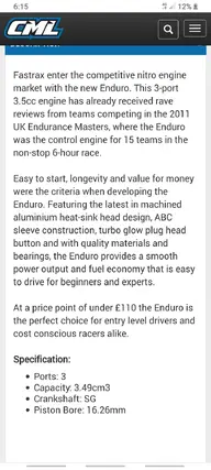

https://www.cmldistribution.co.uk/p...-twenty-one-21-3-port-nitro-engine-n-ps-turbo am looking at somthing like this but am not sure if it will fit ???

In that case, this is a good choice - but definitely you'll want to research if it will properly fit based on what D3MON mentioned about the flywheel.

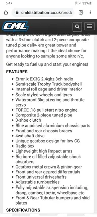

According to the website it already has a tuned pip and dosnt say is its 2 speed so gusse not

2 speed will give alot wider range of usable power depending on how it is geared, as far as the tuned pipe, i have seen very few truly "tuned" pipes on RTR vehicles, especially in the composite variety, (does not mean they are not out there, or that this is the case, but in my experience). personally would probably try to find a novarossi pipe and header combo or ERCM, but those are a bit more spendy.
there is not really blanket "tuned" so many variations of "tuned" pipes and usable RPM range, some tuned pipes can really unleash the power of some engines, others can actually hinder the engines performance.
