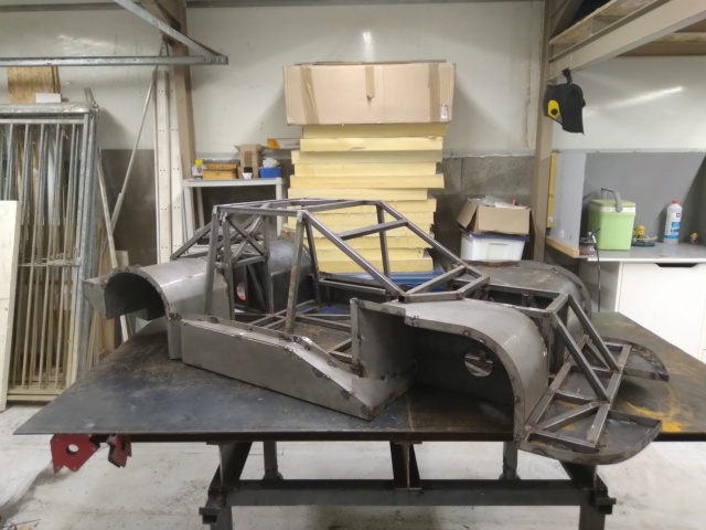

I present you my unique project, the creation of a very large scale RC car at 1/2.5.
I based it on the escudo pikes peak.
To give you an idea of the size:
- 1987 CBR 600 engine with 85hp
- weight about 200kg
- Superkart tires
- driving on simracing and fpv
- Vmax min 200km/h
- 0-100 in about 3.5s
- full steel chassis
- fiber bodywork
- hydraulic control

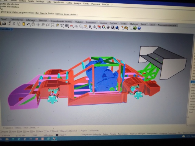

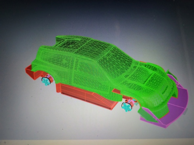

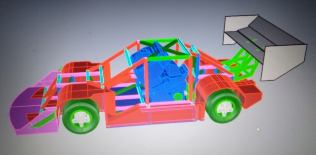

here is the model made in august

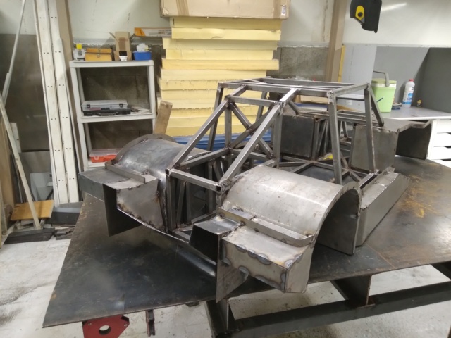

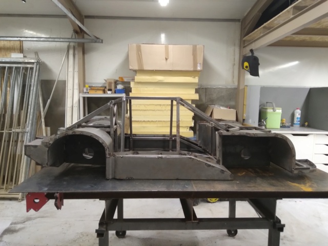

The current frame

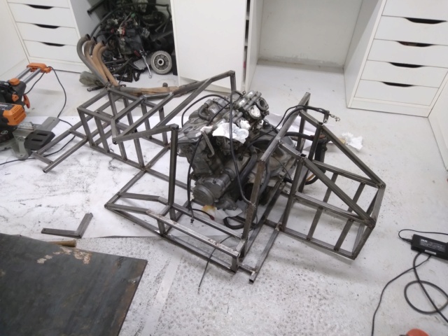

and the chassis in earlier version with the engine
if you want to follow the adventure
