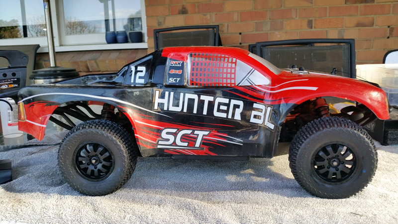

Hunter BL after a thorough once over , its condition when received, which supposedly only had a few months usage ( must have been a very tough few months ) was pretty average to say the least. I bought it cheap enough so I went to work , stripped all the wheels, shocks , electrics out and gave it a good clean, rebuilt all the shocks, new oil 40F/50R, reassembled / remounted the electrics , fitted a heatsink/fan to the motor, bought some new Proline Bandlands wheels/tyres ( originals were shot , one wheel cracked, hex's stripped, tyres full of dirt , etc, they were garbage ) , installed some fresh screws, new shorter turn buckles to address the front toe still being negative using the stock turn buckles shortest setting ? , fresh Lipo 2S , some repairs to the body.
Badlands are 9 mm* offset, ( off Slash 4x4) which is not ideal , as I really wanted 3-4 mm offset, but nothing was available in that offset, so I do have a slight tyre overhang of about 1-2mm. I have ensured the suspension/body height geometry doesn't allow it to easily bottom and touch the body as best I can.
First few test runs went reasonably well, car is deceptively fast out the box with the stock electronics on 2S , took a beating with some pretty big hits , no breakages, but the ESC did cut power to the engine on a few instances after a big hit. Quick toggle on/off, and power was restored. Not sure if that is normal , maybe someone else can give me some feedback on that behaviour.

Hunter with its other stable mate, BL 2S modded Senton Mega 4x4 , with a few other mods re suspension/servo, etc, both trucks are close to par in speed, handling. One thing that I did find odd with the Hunters front suspension geometry is that on compression it significantly alters the front toe out, whereas the Senton on compression doesn't alter the toe at all. That behaviour with the odd standard toe in , does set it a little out of the box, but it seems to handle O.K.

Just had a test run on 3S for the first time this morning, wow, this thing lit up. I ended up winding the throttle dual rate back as it was proving too much of a handful , huge end-o's and roll over flips trying to get a handle on it.
The truck is tough as nails , it took some hits that would have ended the Senton 4x4 , and just rolled over and kept belting. I would have no hesitation recommending this truck to anyone coming into the hobby, it can take massive punishment, is quick on 2S, a riot on 3S , and can be tamed back for the beginners with the throttle dual rate setting, that can be dialled up as they learn to drive more competently.
