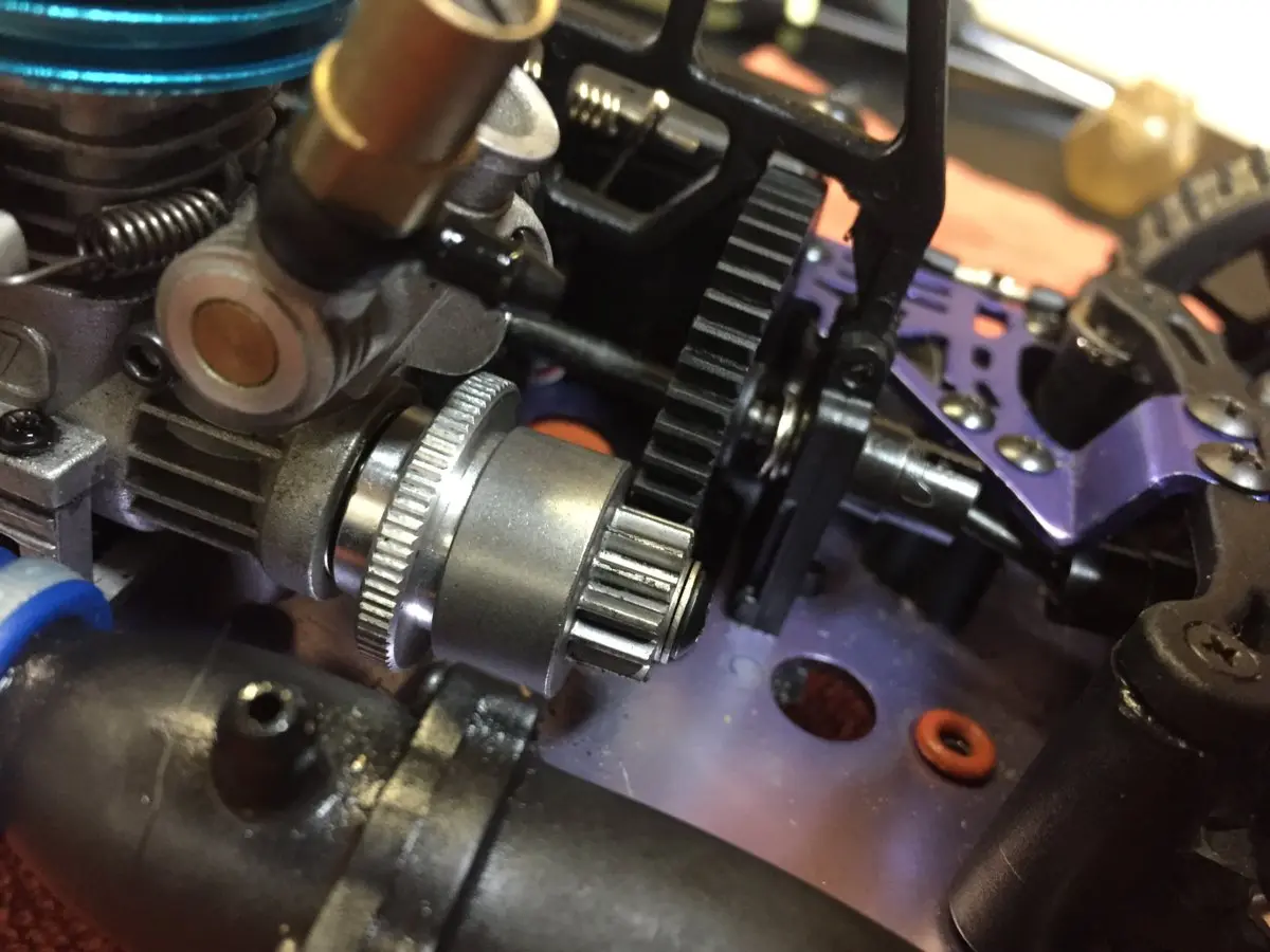

When I push the car back and forth, the gears spin and so do the dog bones, but when I rotate the spur gear itself, it doesn't move the dog bones
No nothing moves with the gear! I'm almost positive that the spur gear is lose because like the bearing with the spur gear, 1 bearing is off and the spur gear isn't like tight to them?
I would take the spur off an check it ,maybe a o-way bearing in there or a pin missing or sheared off!
I have the engine and stuff off right now but i'm new to this and I honestly have no idea how to take it off.. It looks like something is supposed to go in this hole that will hold the spur over it?

So I got a pin back in the spur hear that holds it to the middle drive train, but there's nothing behind the spur gear to stop it from coming off. Is there any thing I can put behind it so it can't move off

The center gears are usually made up of a spool type that has a cup with several gears in them or
one like you have that should have a one way bearing to allow the gear to free spin one way like
when you let off the throttle an brake ,its hard to tell on the pics that you show to se what it consist of.
Might have to try to download a manual an see whats missing!
