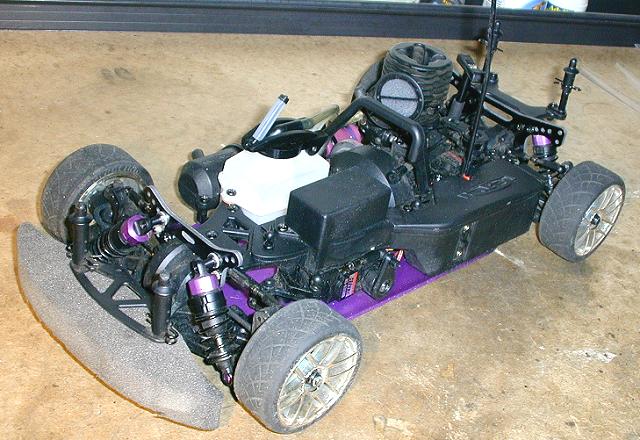

Here was day 2: (sorry about the blurry photo - I took it quick this morning)

Hey CSD, where is the fuel line pick up fitting on that tank? Is it in the front? On my SS it is in the rear. I wonder if they changed it mid model as a buddy of mine has the 18SS like yours and his is the same as my SS12.
His tank is the same as yours, he mounted the tank backwards.
The stock tank sucks, the lines run in a bad way (near the gears) and the plastic output port on the bottom will rub the chassis. The primer will leak and the pickup in the tank is not optimum. The lids on the stock tank and the optional tank are not in the same position so if you cut a tank access hole in your body it may not line up with the new tank. You should upgrade to the optional race tank now along with the hiflow air filter. The race tank is a much better tank. The fuel output is on the top right behind the fuel cap and the pickup in the tank is better. See here (not the best angle, but all I have now):

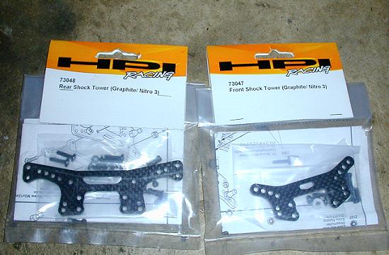

If you run foams you need to use a 2 degree offset in the rear. My ride height is set at about 5.5mm. 0 toe in front, -2 toe in rear. -2 camber front and rear. 10 degree front caster. Graphite shock towers, front shock stood up one hole from stock (adjusted on tower), rear shock laid down one hole from stock (adjusted on tower). Stock camber link holes. Still waiting for my graphite deck.
Yes I mounted the tank backwards as I wasn't comfortable with the location of the fuel lines next to the gears. I will be replacing that tank soon, as well as the filter.
rossb, where did you get the graphite towers? I don't recall seeing those as an HPI upgrade.

The shock towers are HPI parts. A LHS happened to have them in stock. See here:
http://www.rbartick.com/hpi/rs4_30.jpg
I am still running the stock clutch and even with the red gears (taller gears) it can spin all four foams when accelerating off a turn. The 18ss has a lot of low end torque, you have to be careful when blasting out of a corner.
I couldn't get into HPI Racing USA but got into the europe one. I guess I just never noticed the graphite towers before. I am still waiting for my graphite radio tray, like you are ross.
