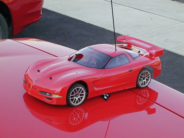

Will this be enough airflow? I'd really like to keep the windshield solid, mainly for looks, but strength as well.
I would tend to say no. Plus you will not be able to refuel with the body on. Cut a hole in the windshield for airflow and tank access. You will need to flip that tank around, better yet get the race tank. I would also cut a hole in the side window.

CSD, as to airflow, you might want to open up the hole a little bit more where your antenna and exhaust tip go through. Every little bit helps. And of course opening up the windshield for the fuel tank will help a lot. Also, lower that body somemore. The more the head sticks out the better it will cool.
But do like rossb says; do not cut the windshield until you decide on your tank options, or at least turn the stock one around if you keep it.

Your body does look a bit high off the wheels and it is certainly higher in the front than it is in the rear. Hopefully you cut the fuel access hole after installing the new tank. The new tank's lid sits further back than the old tank's lid. Set your ride height according to your surface. A normal parking lot will need about 10 mm of height. A grommed track calls for about 6mm of height.
I havent cut the hole or installed the tank yet (I'm still at work) That will come in a couple hours.
The wheels fit the body nice when the suspension is set correctly. I put the large spacers in to keep from scracthing the dinning room table only :) Wife wouldnt be too happy with that. (Dinning room table was the best light I had for taking the photos)
I'll be setting the car to 10mm clearance once the rx/servos are in.

You should think about rounding the edges of your fuel tank cut out. A squared edge may split if you crash.
thats the blue painters tape I put on to make sure the window mask didnt leak - the tank hole barely goes into the window - and is almost a perfect shape with rounded corners. I used a dremel and my conical stone bit to smooth all the edges on the body before I sprayed - including rounding out every corner that was cut. The finished product will be easier to see the hole.
