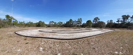

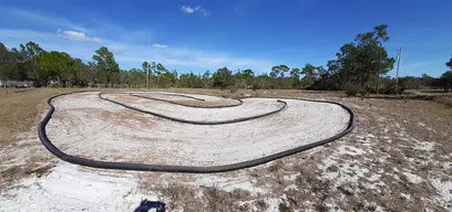

That's really cool, my track is nowhere near as technical, but I designed it where I can convert to oval in about 10 minutes. I have about 8' wide lanes, I am planning on bringing in a dump truck load of clay, and building jumps, since It's all sand on my property.
That's kinda the way they have the local tracks setup here, with the drainage tubing. They can change the track layout pretty easily, but they still have to move the jumps.
