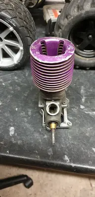

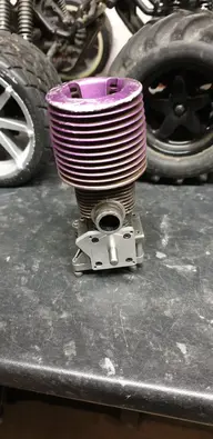

Anyone know what size this is?

Hi guys bought a job lot of stuff off sleazebay and this was in there any ideas what it might be so I can recon it and put it in my truck tia

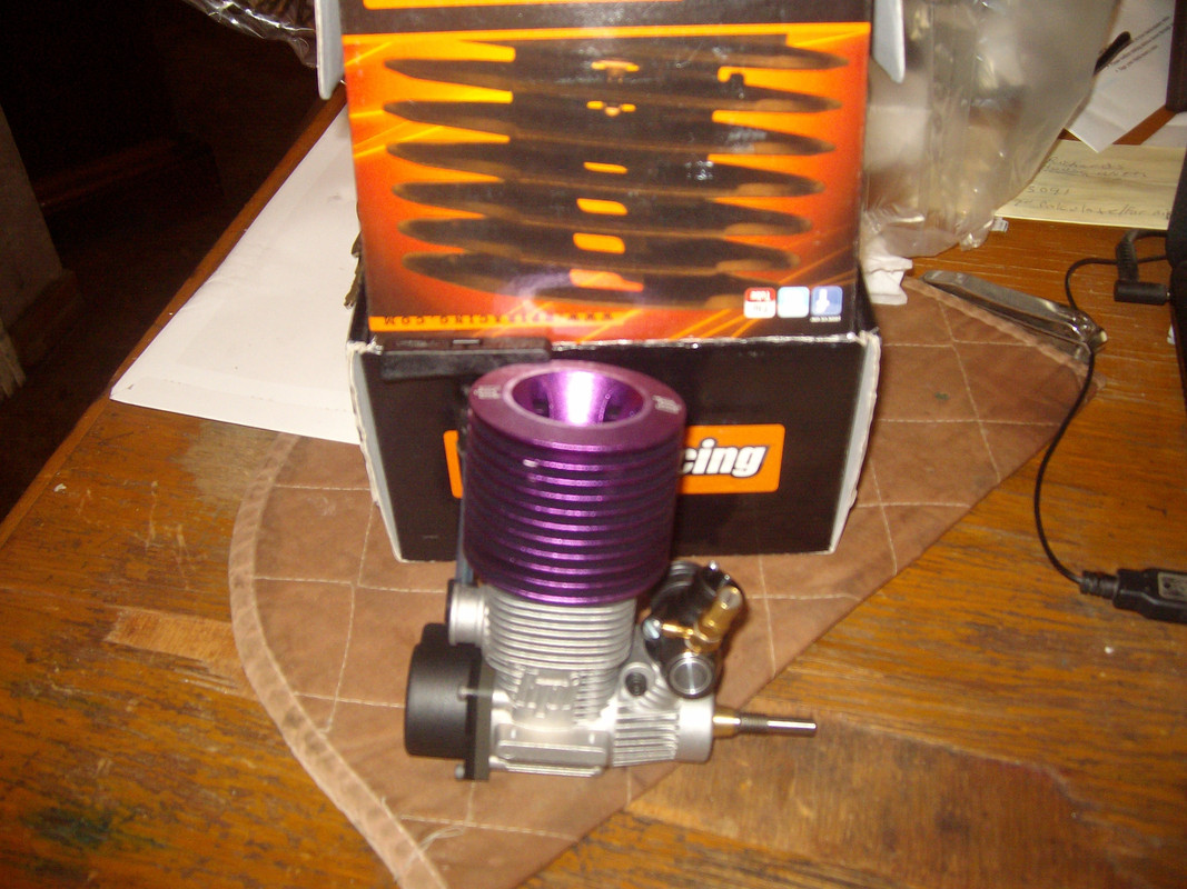

This one that I have is a 25 ,yours seem to have a taller head an has the black block ,not sure if that makes
a difference of what size it could be ,but yours may very well be the 4.6 /28 version!....:cool:

Odds are, one is a small block (smaller than a 21) and one is a big block. A typical .21-.32 nitro engine has the same footprint/bolting pattern.
Sure, there are variations and exceptions to the rule, but typically, .21-.32 is a "big block" and .10-.20 is a "small block". They differ in size between the mounting flanges and from the back of the crank case to the front, so they won't fit in the same engine mount.
Small block vs big block:
The top one is a big block .21ci, the bottom is a small block .18ci.
Just to make it interesting, there's also a "mid-block", which is a big block bore/volume in a small block crank case to fit a big block into a small block engine mount:
That's a Traxxas 3.3 (.20ci), OS21TM (.21ci) and OS.18TM (.18ci). They all fit in the small block engine mount/vehicle without modifying anything. The middle one would be considered the most "mid block" of the three. The right one is a small block. The first one is iffy. LOL!
Sorry... prattled on a bit.
