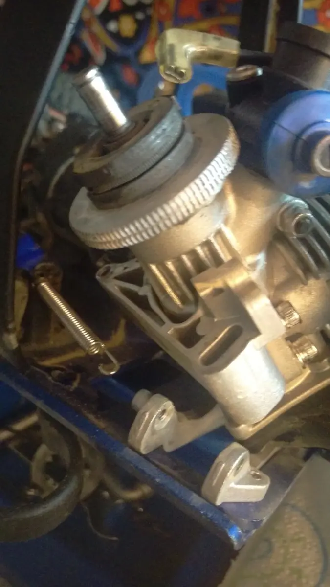

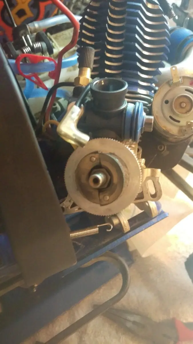

Air filters are ok, they could use a small cleaning but they're definitely not over saturated. Adjusted each screw to factory settings and examined the carb for any dirt. It all seems clean. I'm going to strip the engine and check the o'rings next.
Try starting it in the air, if the tires spin it's probably your clutch spring. Or just pull the CB off and check the spring, easier than pulling the engine and carb apart to check o-rings.
Got it to idle, however it's idling extremely high and tires are spinning like crazy. I'll pull the CB to check the spring when I get home.
If the clutch is good check your CB bearings. If they're bad they can cause similar issues. I wouldn't bother replacing the clutch with a stock one, Dynamite offers a drop in replacement (I think it's a max-life or long life name). Or you can use this time to upgrade to a 3 shoe setup.
