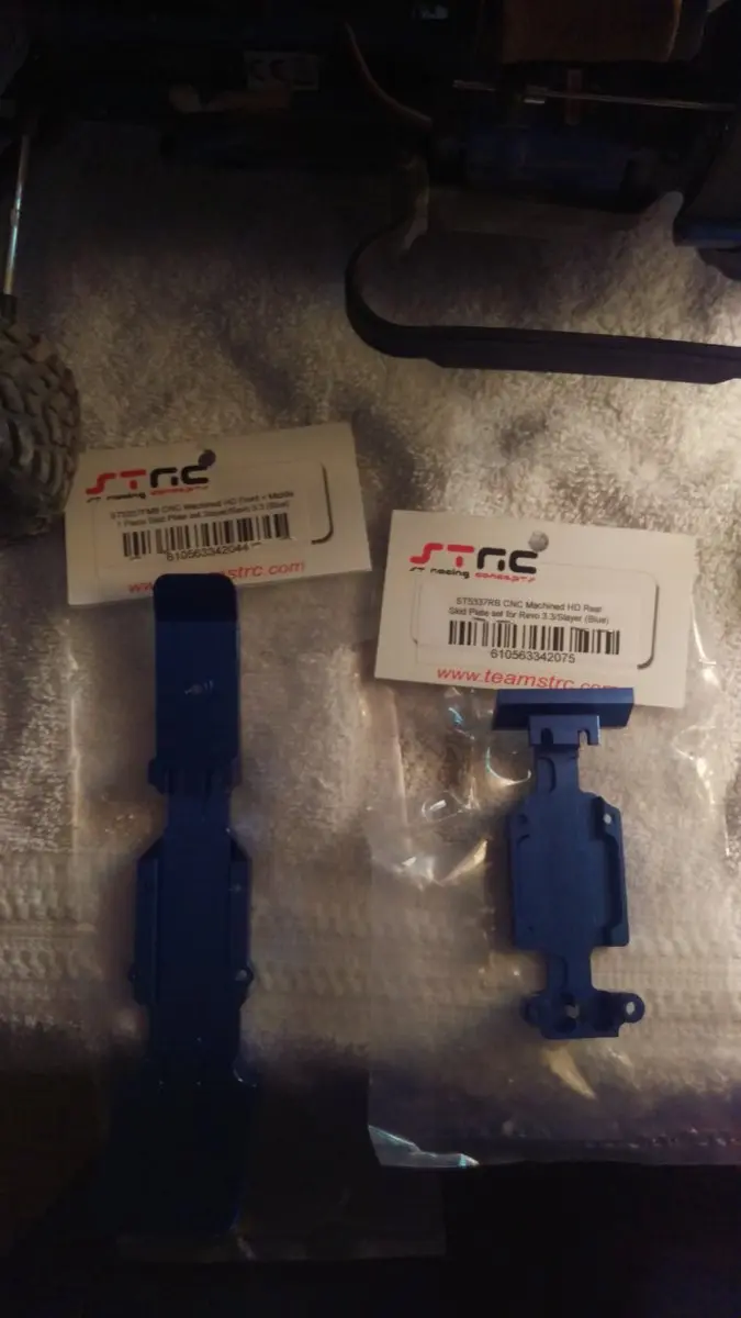

Ok fellas, we've got us a problem now... My truck won't run. I can start it and throttle it to make it move around, but it will not idle. Any advice? On the bright side I've got a beer, and I'm putting new skid plates on.

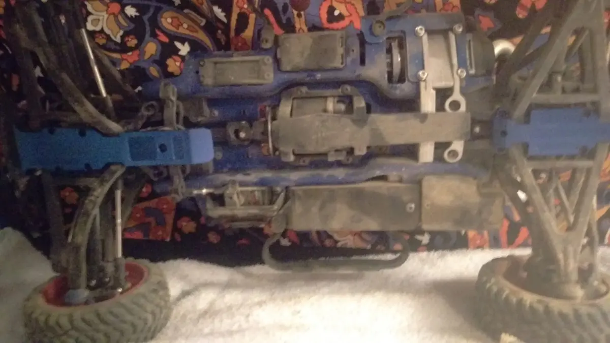

On a side note, I've finished putting on the new skid plates, I just forgot to purchase the middle plate, so it's now on its way and should be in on Wednesday. I seriously appreciate all the help guys. I'm learning a lot and it's making this experience so much nicer. Pictures will be up either tonight or tomorrow. I'll keep you all updated.

I've added 2 new pictures to my album :D Stay tuned for more updates/upgrades.
