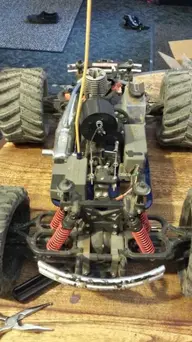

This is what my tmaxx looks like at the moment. Needs a good cleaning lol had to tune it again after installing the air filter and new resonator exhaust and now runs great but hopefully be getting the novarossi 2.5 soon.
