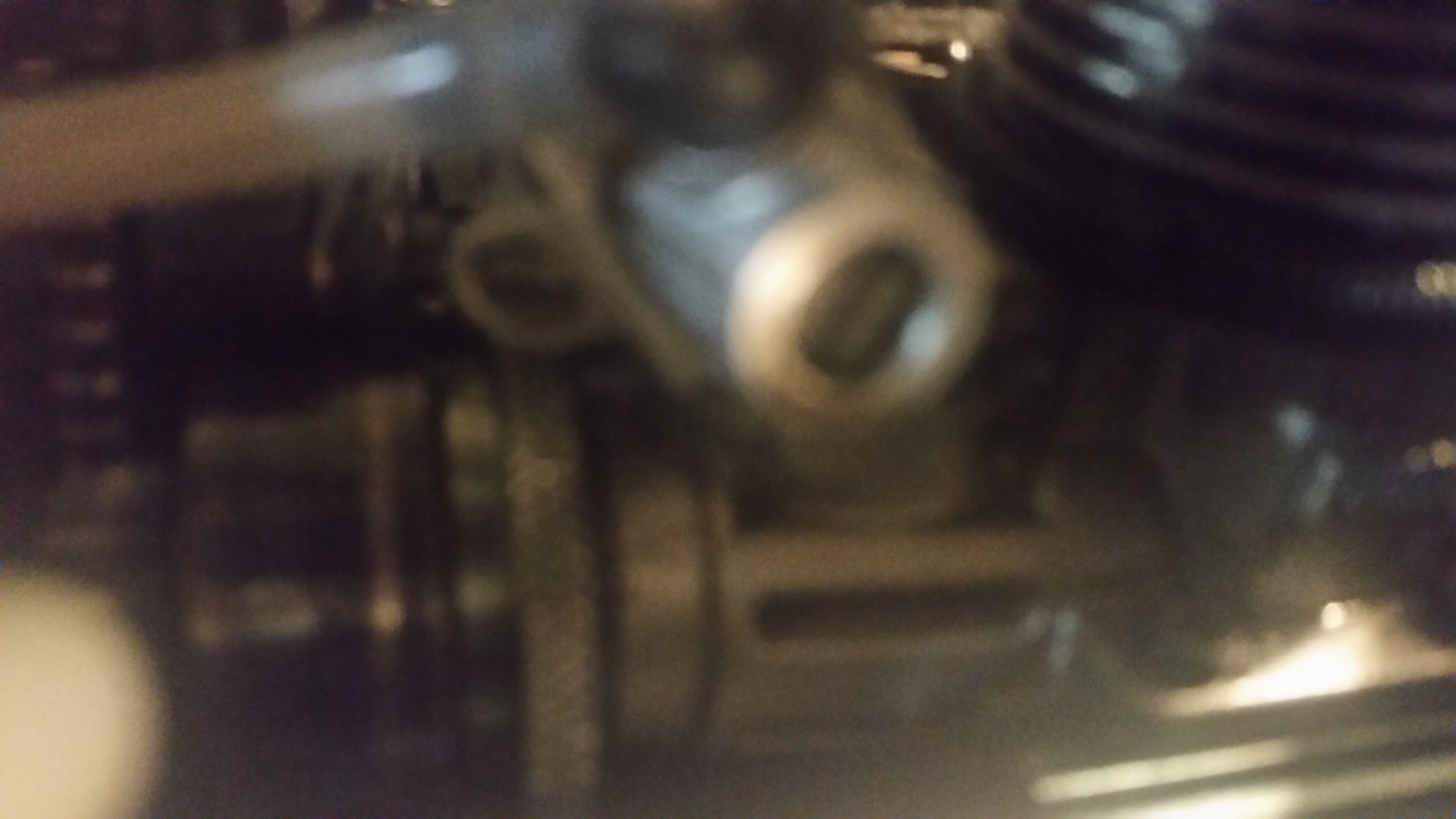

Got it check this out both of you
Right here
1484958828881893224445-jpg.19039
Its not too clear ,but the mid screw looks like its too far turned in ,should be about flush with the housing!
The mid screw is the biggest one??
Yes ,an is factory set an suppose to stay at that setting!
An it appears that your idle set screw is right there just above the flywheel ,I can barely see
a faint of it ,they are alttle hard to get to an if don't look closely ,you wont see it!
But I can see it just under the fuel line nipple ,above the flywheel ,that's your idle set screw!...:cool:
Thanks, so it can't idle so I turn it in just before it wants to run away right?
