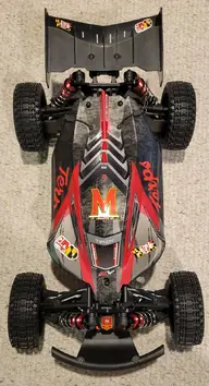

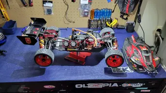

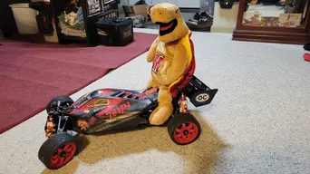

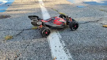

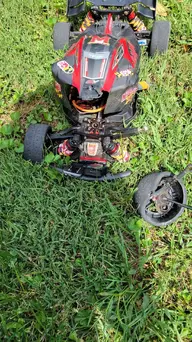

I purchased this off of Craig's List in July 2022. Seller only ran it twice. Came in the box, extra set of Hoons and a battery. Looked brand new and was a great deal. That summer I did a lot of upgrades to it and mainly used it as my 1st Street rig. In October I smacked it into the front tire of my neighbor's car. I then decided it was time to stretch it, add additional upgrades, added headlights/taillights and chassis lights. It runs so smoothly and is def one of my go-to street rigs.
Photos show the 1st three months, after the stretch and now.

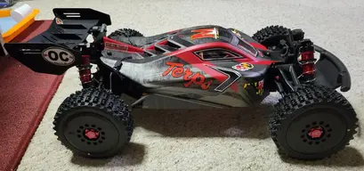

Here are the details of the stretched build and how it is now, as of 7/7/24.

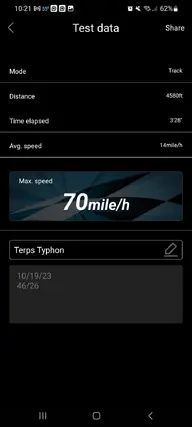

PB speed: 70mph
Motor: (Stock) Spektrum Firma 4074/2050kv
ESC: (Stock) Spektrum Firma 150A
Receiver: Radio Link – R7FG
Servo: DS3235 Pro Servo
Current Diff Fluids: 100/500/60
Current Gearing: 46/26
Current Tires: Power Hobby Belted Gripper tires
  • Kraton Chassis
  • TLR Wing
  • Typhon Front and Kraton Rear M2c Chassis Braces
  • Aluminum Servo Link
  • Aluminum Servo Mount
  • Hot Racing Aluminum Bearing Steering Bell Crank
  • Hot Racing Aluminum Steering Blocks
  • 135mm Kraton Rear Dog Bone
  • Replaced Motor Mount Screws with 3mm Flanged Screws from McMasters-Carr
  • Added Front, Rear, and Under-chassis Lights
  • Red Aluminum Wing Buttons
  • Power Hobby Aluminum Motor Fan Mount
  • 2x 40mm Surpass Rocket Fans
  • 1x 40mm Surpass Rocket Fan Installed on Esc with Custom Made Fan Holder from Tex Koder-AF
  • Kraton M2c Rear Chassis Brace
  • Fast Eddy Bearings
  • Rpm Front Bumper
  • Arrma Steel Rear Skid Plate
  • TBR Rear Mud Guards
  • Arrma Metal Center Diff Case
  • Steering Bushings to Bearings
  • Limitless Front Shocks and Shock Towers
  • Md State Flag Shock Covers (Mack’s Custom Designs)
  • GPM Alum Center Diff Mount
