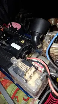

20170102_162541.webp Is this the right spur gear for the tmaxx as my throttle bar gets caught on it
You may have to loosen the carb at the intake and rotate it kust enough for the throttle linkage to pass without hitting the spur gear. I've had to do this before. Looks like the spur gear is the right one for the Tmaxx Classic model.
Sorted it now thank you linkage was too short causing it to have contact with spur gear
