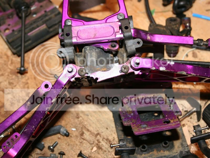

I was undecided on weather to upgrade my savage to an X or not.
Well on Saturday afternoon I was forced to make up my mind.
Got a little to close to a curb and figured I would make it.
I figured wrong.
The last pic is the upgrade kit, new servo case and exhaust coupler.
If I would have left the stock plastic arm's on, I would only be replacing the the arm. Live and learn
I’ll repost on how the upgrade comes together.
wow another aluminium murder. all these crash pic with aluminium should be made stickies on why alumium isnt the best. well now take your wallet out and go fix it.
The upgrade is complete. Here is a list of what’s exactly the same.
All axles including the center shafts (the only difference on the X is no left-hand thread)
Bumpers, Pin brace P#86070, All pins, the out drives, frame braces P#85045=5, All bearings, all link arm’s, steering linkage, all internal trans gears and shocks.
If you break anything in my list above then you will also need to buy them with the upgrade.

Holy cow! I've never seen bent Tvps like that before.. Wow.. Thats...awesome!!
Nice pull man! New upgrade look nice!
