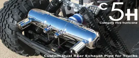

i know the title says for savage but i wanted to asked about all trucks in general
are rear exhausts gud? or just a bling item
c5H600x250titleimage.webp :D
i do like it but whats everyones thoughts :\

Hi,
Sure it looks good, but does it help deliver more power to the engine?
I'd love to hear it roar, or purr... who know what it will sound like at high rev?
I learned to love the look of these Savage X with the side mounted exhaust.
Where is the pressure tube back to the gas tank on those double units?

Hi,
That looks different from the first pic, the small middle pipes are horizontal.
Here they are sticking up vertically.
By the way, duel exhaust isn't probably needed on these tiny nitro engines?
Aside from looking unique, is there really a purpose aside from esthetics?
That would look great on a VW model too though!!

I think it's purely bling honestly. There's basically no header now either, as it's just a straight shot into the pipe. I think it looks neat but I also think it won't perform any better, if not worse.
The guy in the video is also running a K&N filter, so this is probably the best pipe out there, and will be a requirement if you get a supercharger. I'm kidding by the way, if this is anything like the RD Logics' dual exhaust, it'll make your truck hard to tune and take away from your performance. If you plan on doing any bashing, it'll probably get destroyed from any ass end landings.
I am sure the length of headers is important for the performance of the 2 stroke engine on low end and on top speed.
The pipe in question is not a tuned pipe, it does not supply enough back pressure and you can expect to lose performance and engine life by running one. One bad hit on the rear bumper and it will be destroyed. You would be much better off with just the stock pipe when comparing to this fart can muffler lol.
The CVEC exhaust is the only one that works as far as a dual exhaust. If you can find one. They are some what hard to find now.
Don't waste your money on a dual exhaust, they don't work as well as a tuned pipe, they don't have the fuel scavenging like the tuned pipe either. Their for looks, not performance. Get a good tuned pipe & manifold & get more power.
