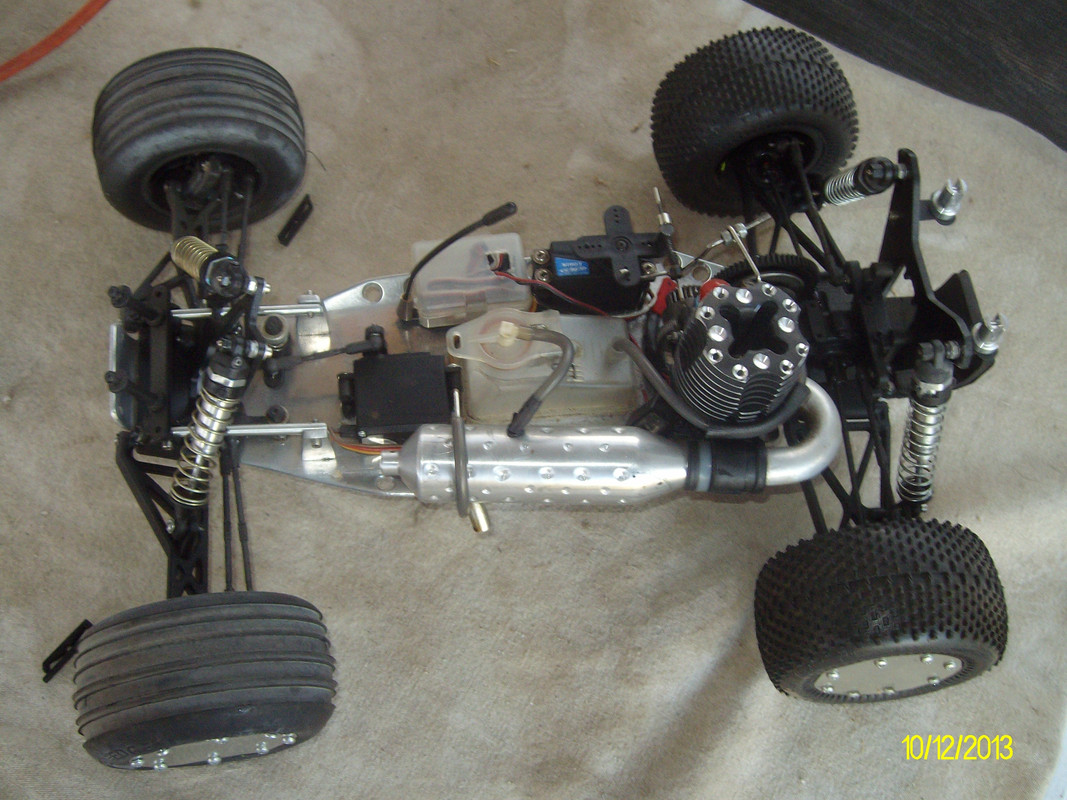

I have one like that ,mine has an OS cvr 18 on it ,but you can use another engine as
people back in the day use to put different brand engine on them!
Mine was in that shape like yours as I bought mine second hand from E-bay ,yours
will take a lot of elbow grease!
Here is mine after rebuild!

Mine was in bad shape ,the owner didnt clean it an left the chassy fuel soaked
for years ,eventually the old fuel had discolored an ate the iodine blue off the chassy ,
the head of the engine was badly scared & scratched ,the linkage rods were badly
rusted ,they cleaned up nice on my bench grinder with a wire wheel!

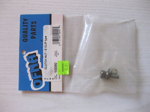

If you do cut the crank ,you would need one of these types of clutch nut to screw on ,you
would need to make sure that you get the right thread size or find a local hobby shop
that knows how to do it ,or find an engine guy like Adam Drake's engine service to do the
work!.. :cool:
