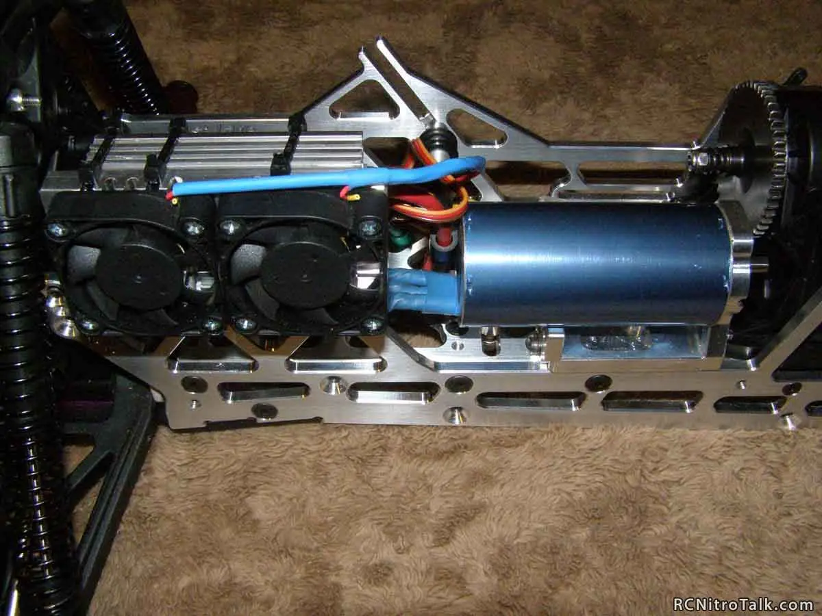

Yeah, I ordered the fan too. What's the screen for?
The fans go wild.

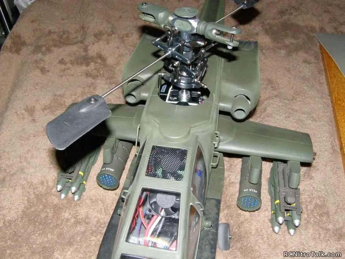

I'm still checking my backup hard drives for the pics of my heli.
Ah, got it. It's the 500 size and the added weight of the body and gearing changes made it necessary to cool it. I cut out a window and replaced it with a piece of metal speaker grill and the fan got all the added air it needed.
full
Here's what's inside with the canopy off:
