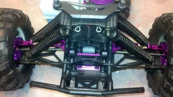

New (to me) Savage
Has Some Small upgrades, But i think i'm really going to enjoy this truck:D
Anyone have any Upgrade suggestions to make the truck more reliable or faster......dont think it can get much tougher.
