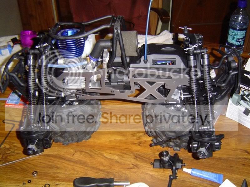

well, i finally got another savage:celebrate: and I've been working it over.
heres a shot like it was when i got it.
it was mostly just dirty (very dirty) SO, i did what any rc nutt would do.. i tore it completly apart!!:dance:
stripped the purple off the hpi parts, cleaned everything, and in the process of replacing the broken or worn parts.
the truck had a dual disk brake setup, rrp steel cb/spur, and a hump pack on it already.
I had the O.S. .30, the joes, a reverse setup, rx for my mx-3, fail safe, and a hitec 645. and got all that installed
so far I've ordered
ofna sliders, steering posts (one was broken), upright set (stole it off mine to fix shannons at the bash), fuel filter, antena tubes, integy chassis braces, and 14mm hexes.
still have to get a pipe (no plastic crap on here!!!) the wheelie bar, triple rate springs, a body, and some body posts (there worn pretty bad)
heres a few shots of the goodies
and heres a shot of it as it sets right now.
more pics later as i finish it up!

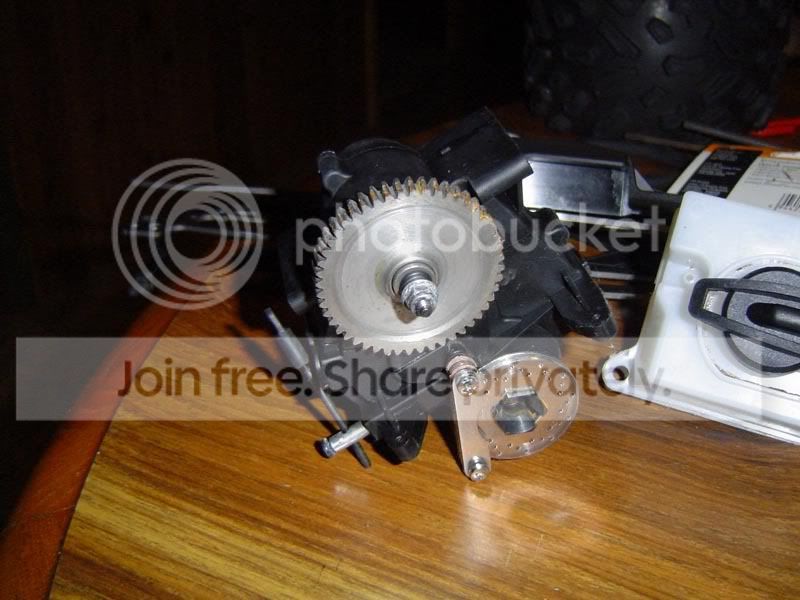

does that steel spur come with the savvy-x or is it aftermarket, please elaborate! thanks
Aftermarket bro.. Stock spur is a plastic one using a Dual slipper kit.
She's lookin very nice! How do you have your fuel line routed? Is that through the shock tower?
yea its through the tower, makes for a nice little loop in the back to reach in and pinch the line to kill it if you want to. but i plan on putting the fuel filter back there and i also have a header tank i may install.

Very nice! It's a good thing you've got the X rollbar setup on there... I've seen videos of what the os 30 will do.

The only other thing is, the exhaust coupler you have on the .30 may not be thick enough to seal against the stock savage header. Somehow, the purple hpi one is about 2/3rds thicker than a normal gasket.
You might also want to put some heat shield on the fuel line, where it lays on the header (to prevent heated fuel hitting the carb).
the .30 vg is specificly for the savage, and came with a header gasket. and I'm gonna reroute the fuel line after i put in the fuel filter and header tank.
digger, i wanted to so bad!! but i stole parts off it so one of the other guys could keep bashing.....
