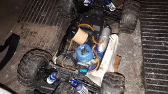

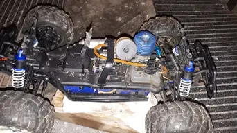

Is there any way that you can take a pic of your rig?
The reason why ,is there is more factors that play a roll in how the engine runs!
It will run at 2/3 throttle for about 3 or 4 min but if I go full throttle or no throttle it stalls. I'm so frustrated.

Sense the truck runs for about 3 to 4 min. ,an shuts down ,an it wont do full throttle ,it sounds
like that it is starving of fuel ,an ,you probably already been all over the needle settings an it did
no good!
Is that correct?
If so ,then you will have to go through step by step with every thing ,starting with the fuel tank.
I personally do not care much for that fuel line ,it is colored .an you can't see the fuel flow ,an some
of that fuel line can be real thick in diameter ,which can restrict the fuel flow ,also ,try removing that
external fuel filter.
Take the tank out ,an clean it out real good using hot soapy water ,as you do so ,now is a good time
to check the tank pressure ,as a leak can cause the engine to run lean an over heat an shut down or
not get enough fuel when your trying to go for full throttle!
Try these first ,an see what we can come up with!
