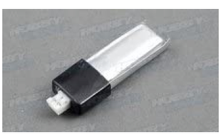

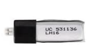

The only thing I know about these batteries is that they are 3.7V.... I’m not sure about the two batteries that I had bought sometime after I bought the helicopter but at least I can tell you the original battery that came with the helicopter is 150 MAH.
The two new batteries I just bought recently which look like the batteries in the first two pictures below, look identical to the two batteries that I had bought after I bought the helicopter a long time ago but I don’t know what these new battery's, and those other older two battery’s MAH is, because the listing on Amazon’s site for these two brand new batteries I just bought doesn’t say what the MAH is. If I had to take a guess, since they’re a little shorter than the original battery, probably maybe 130 MAH? Your guess is as good as mine.

you can't tell what mah is by it being shorter . the new lipos are higher C rates than those 10 yeas ago and have more mah due to the improvement in lipo technology.. that charger will charge any 1 cell that will plug into it .it will not matter what mah it is as the go by voltage 4.2v is tops ..
