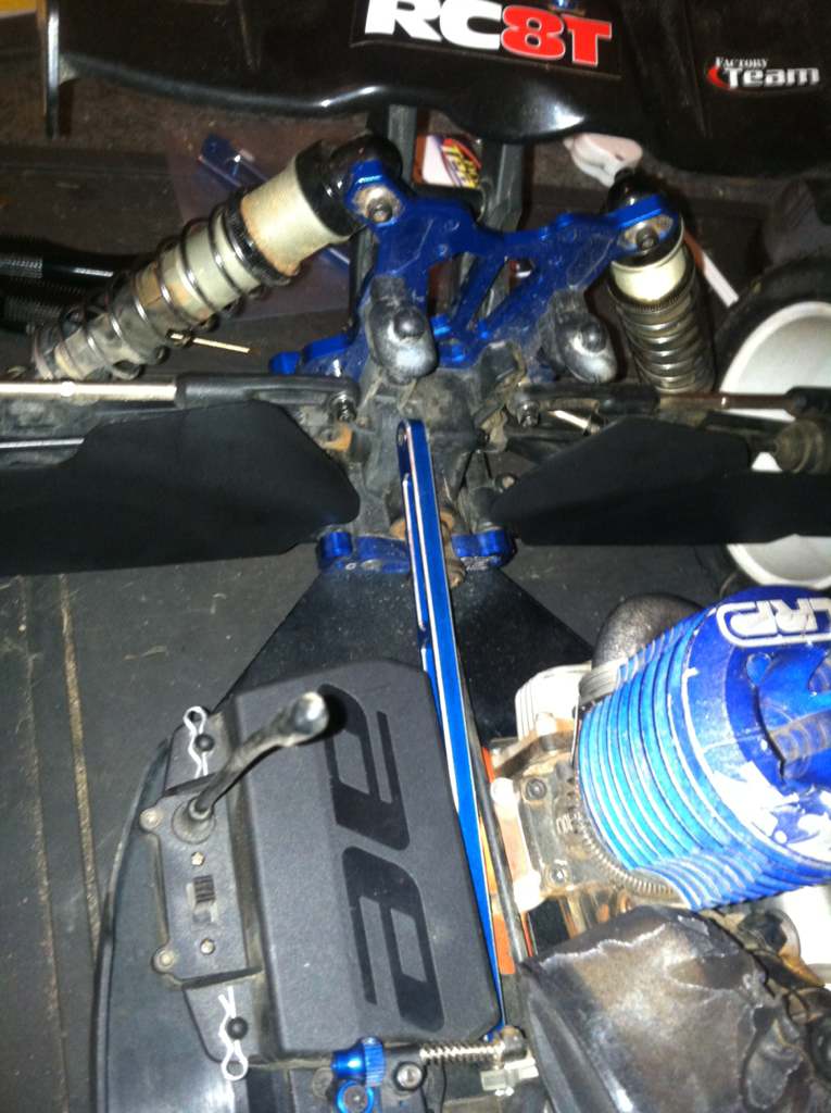

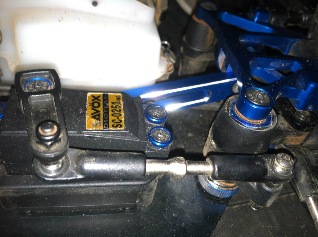

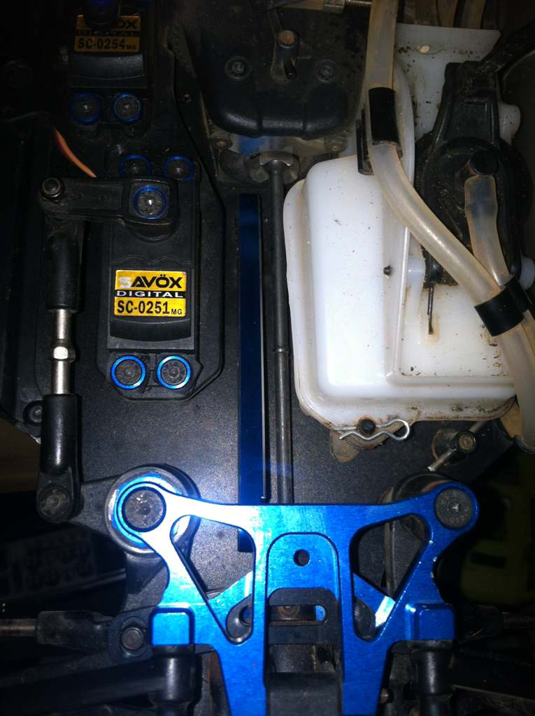

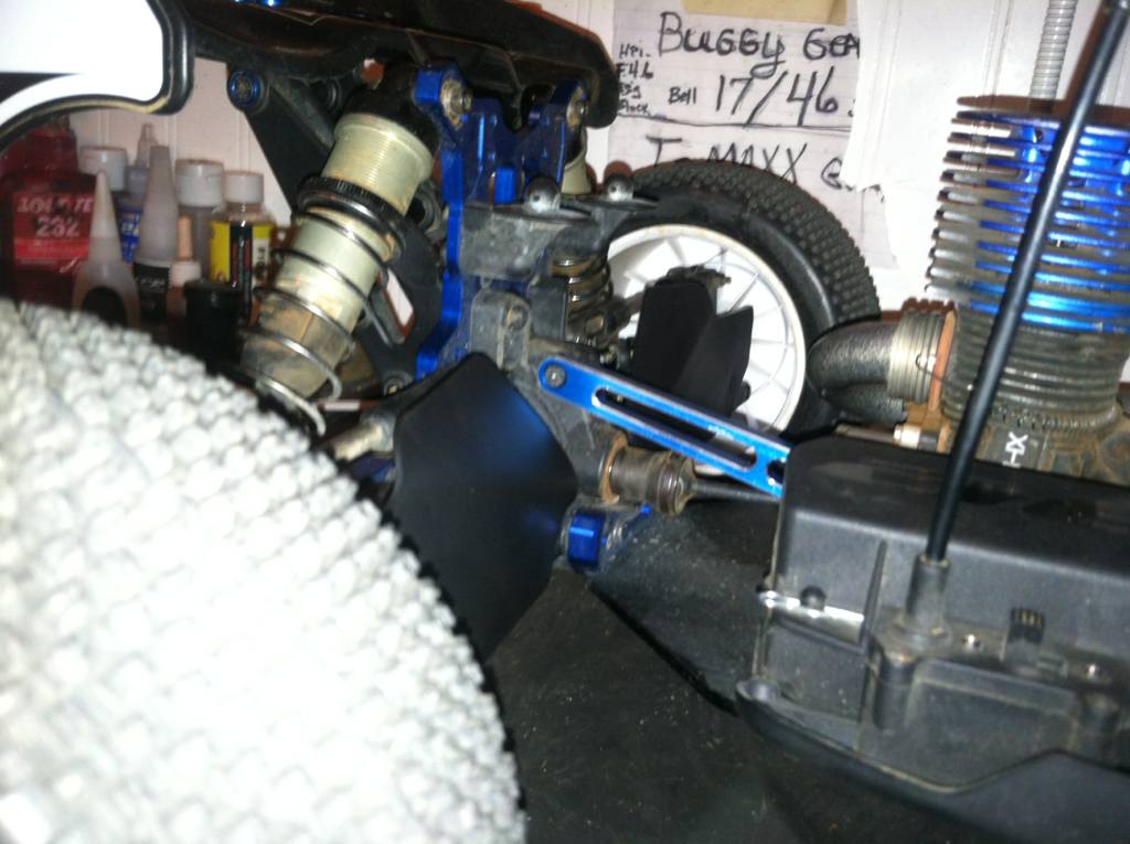

Got a few new upgrades to add to the build now. Installed two new Savox mg servos, a sc0251mg on steering and a sc0254mg on throttle/brake. Also new blue anodized 7075 front and rear braces and lastly a set of DE racing mud guards for the rear. Will post pics as soon as i actually get the braces and guards installed. Thinking of getting front and rear DE racing skids for the chassis as well.
