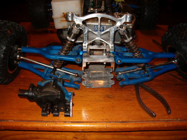

Ok ,rotating the trans spur gear the same way that the engine would be turning ,the front diff is the one that
is turning backwards ,so ,I have to pull the front diff an turn the spool around!...:cool:

Well I got the diff out ,an sure enough when I rotate it for forward motion ,it turns backwards!
So now ,I am going to pull it apart an flip the spool ,but anyway ,I am glad that I caught it before I started the truck!

I am still getting resistance down on my axles ,however ,the diffs are rotating smoothly an in the right direction ,I think
the issue is in the hubs & hexes ,I am going to check it out today ,the weather is starting to warm up ,so I am starting
to get around better as I can't handle cold weather anymore ,the truck is ready to test fire as soon as I figure out what
the resistance is coming from!.... :cool:
Ok ,found the issue ,I may have the wrong diff mounts on it ,I loosen the front diff screws an now it rotates freely ,
The diff mount differ from the front to the rear ,they are a different angle ,so I have to pull the front diff out
an change them!
LOL.....that's what it was ,now I can touch the spur an it spins all the running gear with ease ,all this time ,I had
just shoved it to the side ,but also its been cold an I had a hard time staying focused on any RC's!... :cool:
