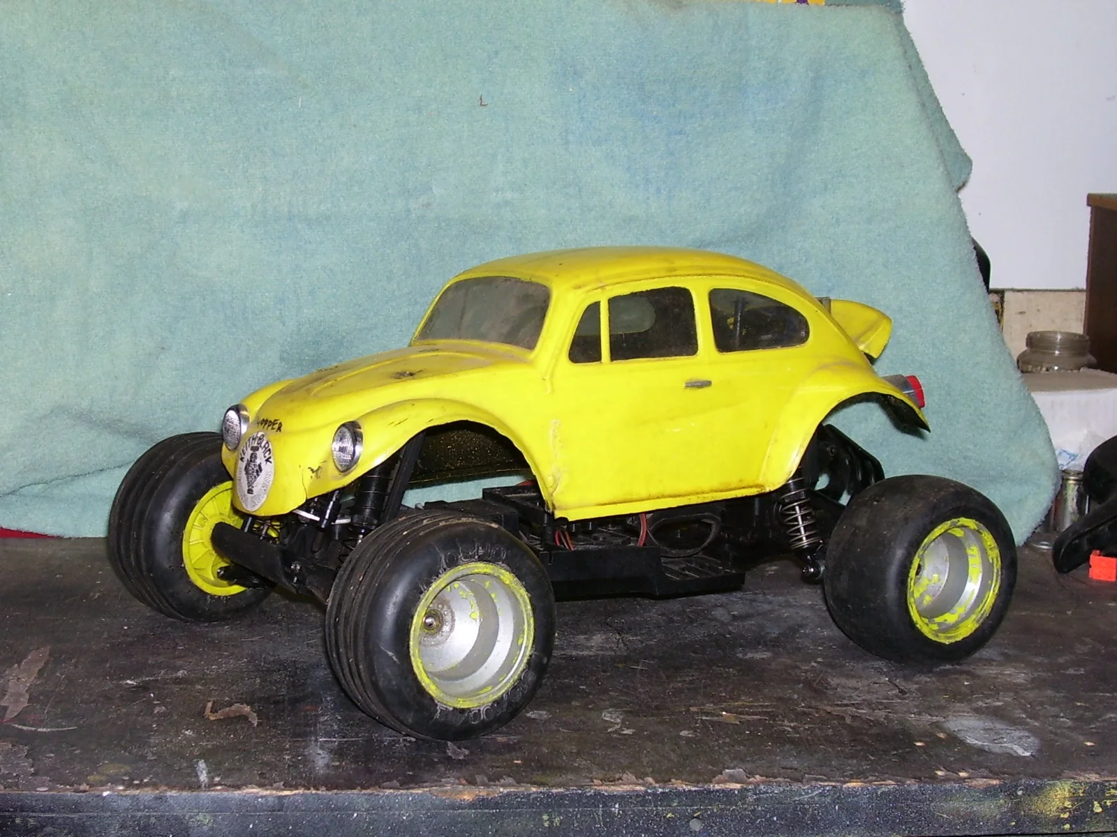

Bummer the ball studs are giving you a hard time! I never owned one of these. I don't know any tricks on it, yet. 😉🤣

the balls aren't stock. stock was a screw and fixed link. i robbed the stud and "adjustable" links off a Tower Hobbies ST15 (which seems to be some kind of Kyosho knock off) what was causing the issue is the thread pitch. the screws were a course thread and the balls are a finder thread. sticking the fine thread into a hole that had a course thread in it for 20 years doesn't work. i did buy a new Ultima rear bulkhead but for whatever reason didn't use it. i did things the hard way. filled the original with JB weld, drilled the holes out and threaded the ball back in. i also previously had conical washers between the bulkhead and ball, iv sense removed those to get more thread engagement. haven't driven it sense so idk if it's fixed, but it's different.

I found I had to use the cone washers because the rod ends would bottom out on full suspension flex on the Mid. 😐

i don't remember why, i just remember when i threaded the balls in after removing the washers i did leave some space, i didn't thread them all the way in. we'll see how that plays out next time i run it. (4th of July weekend maybe)
