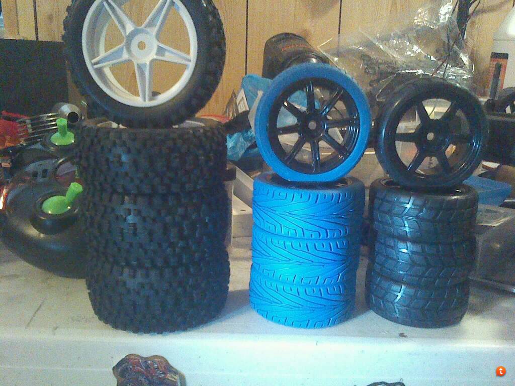

Got my 3 sets of 4 wheels and tires today, 2 sets of onroad and a set of oversized offroad rally, what do yall think?

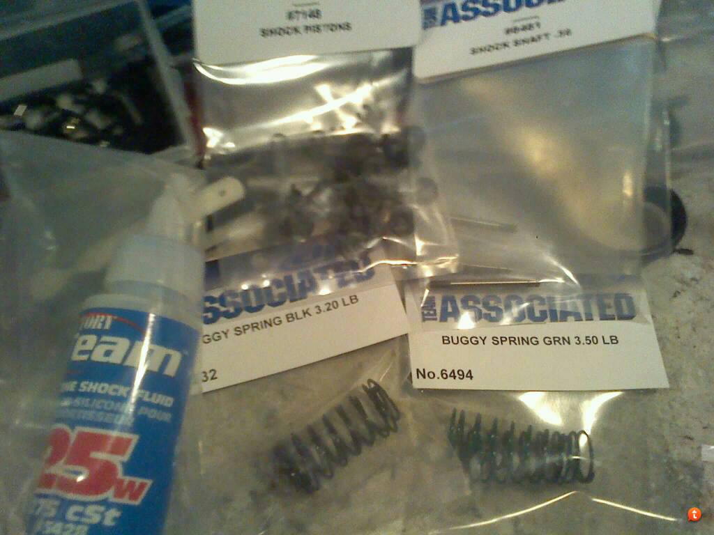

Also got my rally suspension parts in as well.
Starting the first step into getting this rig converted to a rally car, starting with the new suspension parts.

TC3 Rally Kit Shock Setup:
#6461 .56" Shafts x4
#6494 Green Springs For Front
#8232 Black Springs For Rear
#7148 Shock Piston, Use #2-1.2 For Front
#7148 Shock Piston, Use #1-1.2 For Rear
#5429 25wt Shock Oil Used On All 4 Shocks
