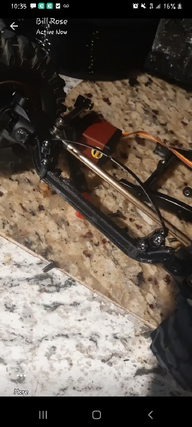

Front steering is completely custom single leaf ford styled suspension of the late models
Rear is spring and leaf for stiffness

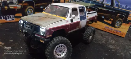

Hbx devastator with 74 gmc body
Stock

The second times the charm...made the axle house 1/4 inch thick and she made it to 78.3mph once on a 2s then broke the engine house plate on the way back i assume i cracked the plate on launch after 7 rebuilds of it getting thicker it was dangerously close to the edge
