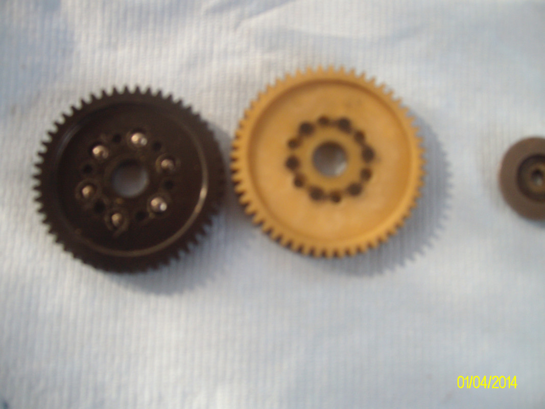

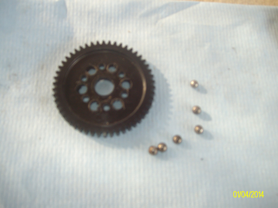

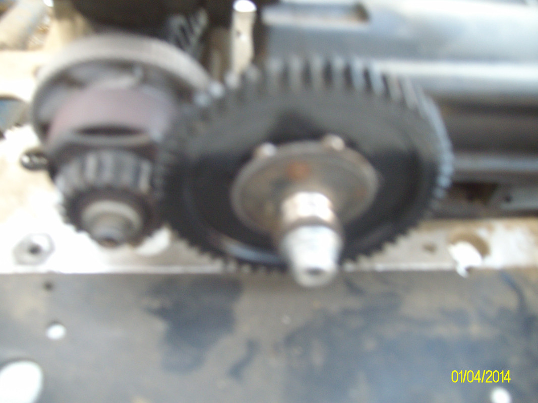

I just have the stock slipper currently, which is the one with the little plastic pegs. Are there some better options out there? I see some ones with actual pads, etc, but not sure they will work.
How does that work with the ball bearings? Wouldn't the disks spin on the bearings?
