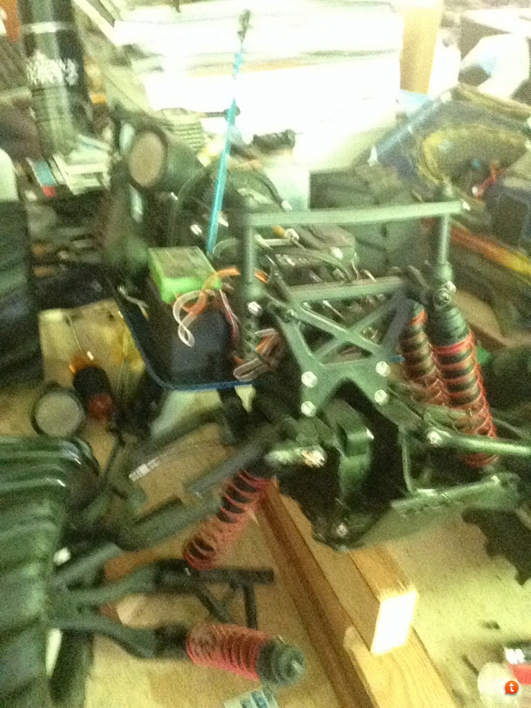

I crashed one my tmaxx I just got. my throttle servo stuck wide open

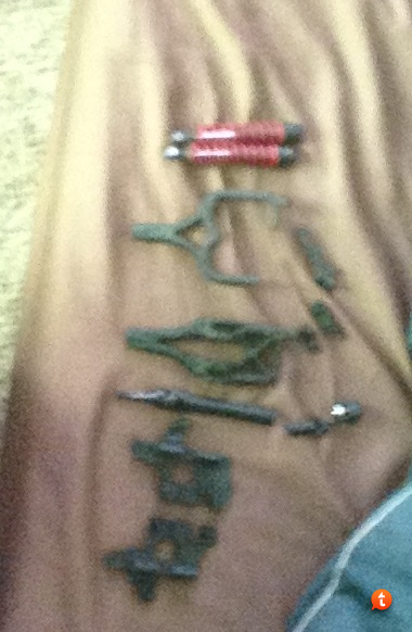

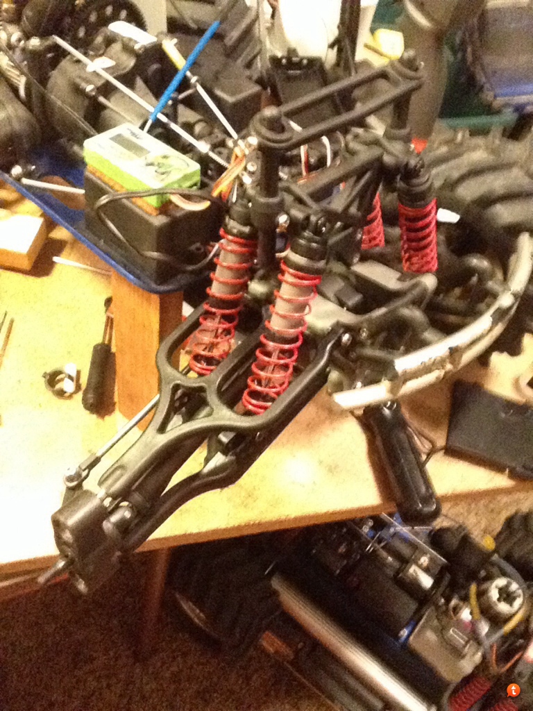

I have to get new a-arms , drive shafts, shocks, new servo and a fail safe .
IMG]http://img.tapatalk.com/d/14/01/30/u3eme3a7.jpg[/IMG]
Man that's some carnage alright. Thanks for sharing. :thumbup: That green case on your receiver box, is that a fail safe?

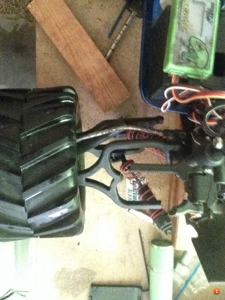

This would be the perfect time to upgrade to some aluminum bulk heads (NOT Integy) and RPM control arms, even if it's only the front.

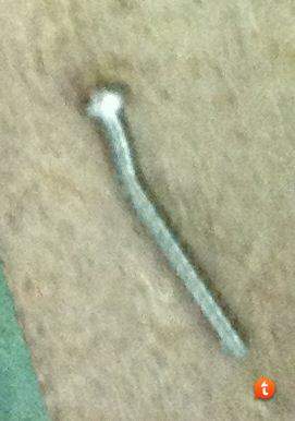

Chances are your hinge pins are bent so you check those over along with your turnbuckles and tie rod ends, and bumper brackets.
Also inspect your suspension knuckles for cracks, knuckle bearings and pivot balls.

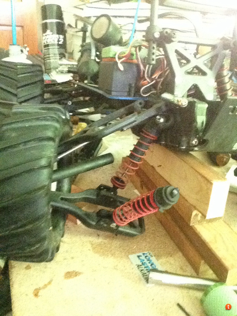

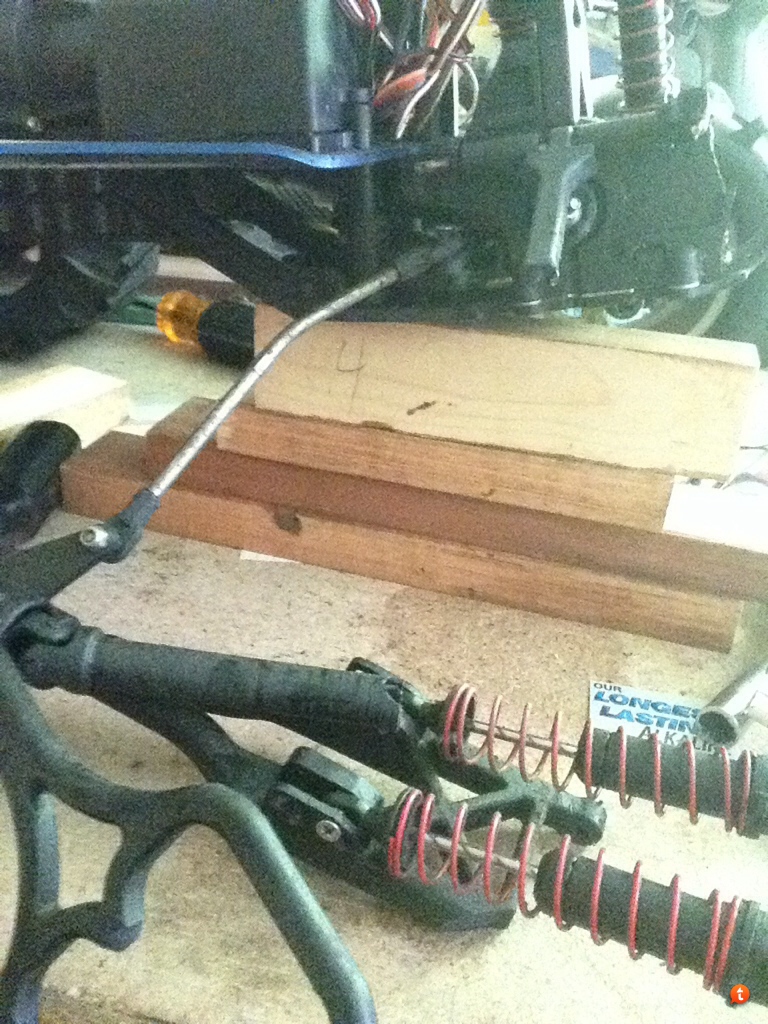

I have been here more than once lol I to used blocks to hold it up for a while but you can craft an awesome stand out of PVC pipe makes changing shocks, control arms, tie rods, etc.

Another view
No chassis damage? By the looks of the tree I would of guessed a bit more damage
I just got it and guess the previous owner turned off the failsafe don't know why but I turned it back on and I think something was up with the servo so I got a traxxas 2055 to replace the 2018. Stock it had the black bulkhead I could only get the Gray and I had to dremel out some plastic and then it fit
so that should help
