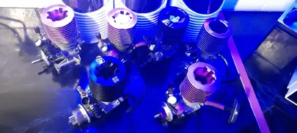

i have about 20different nitro engines 21-30size more than 10 nitro cars, i know things actually :)
