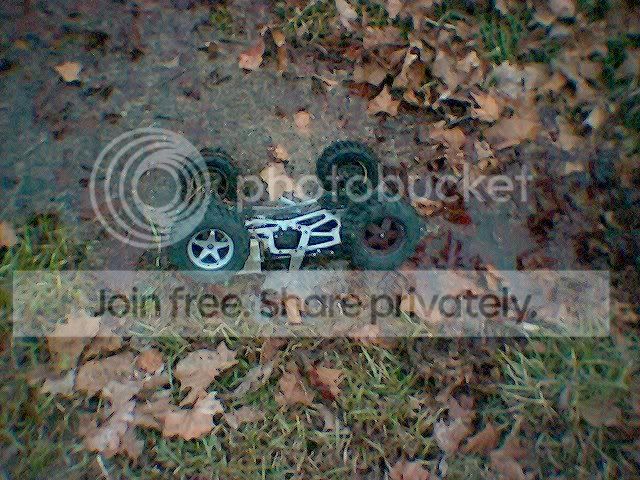

Holy HELL! I was coming down a hill she flipped over and ended up rolling down the hill "RUNNING" and came to a stop in the lake up-side down.
Of course as soon as it hit the water it stopped. I ripped the air filter off and turned it upside down. Took the reciever cover off and removed the batteries.
Just so happened my Father-inlaw had some WD-40 so I sprayed it in the carb..... TONS of it... and turned it over.....
I need the RCNT GODS to tell me what else to do....

Update.... I turned the Maxx on its side... and water is dripping out of the tranny....... HELP!
keep flushing the engine with WD-40, remove the glo plug also and do more flushing,
remove your servos and take them apart and allow them to dry for a few days, same for your receiver.
id go ahead and pull the tranny apart also to make sure there isnt any water in there, make sure no water got in the fuel tank also.
Take everything apart, clean and lube.....The electronics will be questionable but the rest of the truck should be fine.
