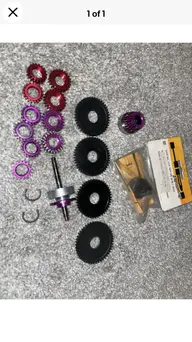

2 speed kit with extras. I paid 60 for mine with 2 spurs no extra.
https://www.ebay.com/itm/154856987815?hash=item240e321ca7:g:Kp0AAOSwrmRiEF2G

The eBay ad you posted. I’m working with this guy as we speak. He’s the one I got the threaded clutch bell and gears from. Awesome dude for sure.
And yea the trans parts are hard to find.

You were bidding on those?
Super hard to find and well worth the price I paid.
