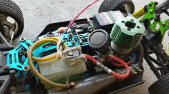

here it is with what I think is a little long pressure tubing
Length of tubing is far less important than the flow of it. That loop is pointless, I would get rid of that - it looks like it's causing more of a pinch than if you just arced it straight to the muffler from the tank.
