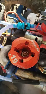

RTMAXX RC Newbie Messages 6 Reaction score 0 Points 36 Jun 28, 2022 #1 Seeking factory carb setting for a Dynamite .19 motor. Any help would be greatly appreciated. Thanks RT
coldvod RCTalk Talkaholic Messages 339 Reaction score 297 Points 183 Location Ontario, Canada RC Driving Style BashingCrawling Jun 28, 2022 #2 Which .19 engine is it? The trx replacement one? Try a flush hsn, 1mm idle gap and 3 turms out lsn
RTMAXX RC Newbie Messages 6 Reaction score 0 Points 36 Jun 28, 2022 Thread starter #3 RTMAXX said: Seeking factory carb setting for a Dynamite .19 motor. Any help would be greatly appreciated. Thanks RT Click to expand... coldvod said: Which .19 engine is it? The trx replacement one? Try a flush hsn, 1mm idle gap and 3 turms out lsn Click to expand... .19 dynamite engine RTMAXX said: Seeking factory carb setting for a Dynamite .19 motor. Any help would be greatly appreciated. Thanks RT Click to expand... coldvod said: Which .19 engine is it? The trx replacement one? Try a flush hsn, 1mm idle gap and 3 turms out lsn Click to expand... Okay, thanks and yes its the trx replacement. Attachments 20220628_192929.webp 117.6 KB · Views: 106 Last edited: Jun 28, 2022
