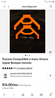

Tell me about the bumper supports, are they printed or what? I need new ones for mine, don't really want to buy the TRX bits since they're kinda weak. Nice rig brother!😎👍

Indeed they are printed, I got them off eBay I will have a look and see if I can find them again.
I will confirm that they are very robust and durable, they have plenty of "give" which is brilliant for what they do. Watch how I will break them next time out :D

Thanks! I found some, look's like the ones you have may be from UK?
These are the ones I found in US.
https://www.ebay.com/itm/1563088873...OSAymslDbTxKPm88/N9rbDneI=|tkp:Bk9SR8D4qsW7ZA

Mine will be from UK. The only difference I see other than colour is mine are rounded edges but that shouldn't matter at all as long as they are flexible and robust for $16 its worth a shot.
