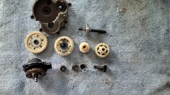

Hey guys, I have managed to smoke my 2 speed again.
The first time, it blew the wide ratio gear set. I replaced it along with the primary clutch.
Second tank in and it blows again. This time the wide ratio gear set stripped, the pins flew out of the primary clutch and the bearings on the diff pinion fell apart.
The surface I was on was very very loose and dusty. Maybe the truck was shifting too hard into second gear because of the small amount of traction?
I don't think the slipper is set too tight either.
Engine is an OS 21TM, so I don't think it is over powered..
Not sure, Any ideas or solutions? :\

I would go with a 2 speed RRP gear set. If you strip those then something else is wrong. I am running modded BB Maxx trucks and have never stripped a set of the RRP gears. I have a Maxx with an Sirio .18 on it running the single speed and I can tell yah it def isn't slow.

With a big block and a forward only, the weight/inertia doesn't pose much of an issue. I run RRP steel in my revo for all gears in the trans. Got tired of taking it apart every time I ran it to replace something... that was two years ago. Haven't taken it apart since.

I would suggest to replace all gears in the trans along with the bearings and use some shims when installing as there may be some play somewhere along the line causing the gear strippage and pins snapping[COLOR="Silver"
You can lock it 2nd by making a plate to relace the 2ng gear clutch or you can groove the 2nd gear clutch in 3 places and put screws into the gear to lock the clutch to the gear.
Oomp over at BYT forum used to make the 2nd gear lockout plate in I rember right.
