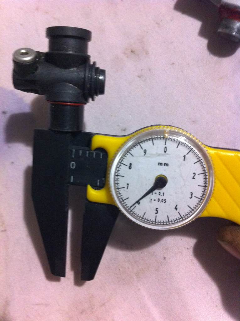

here is the stock trx 3.3 carb

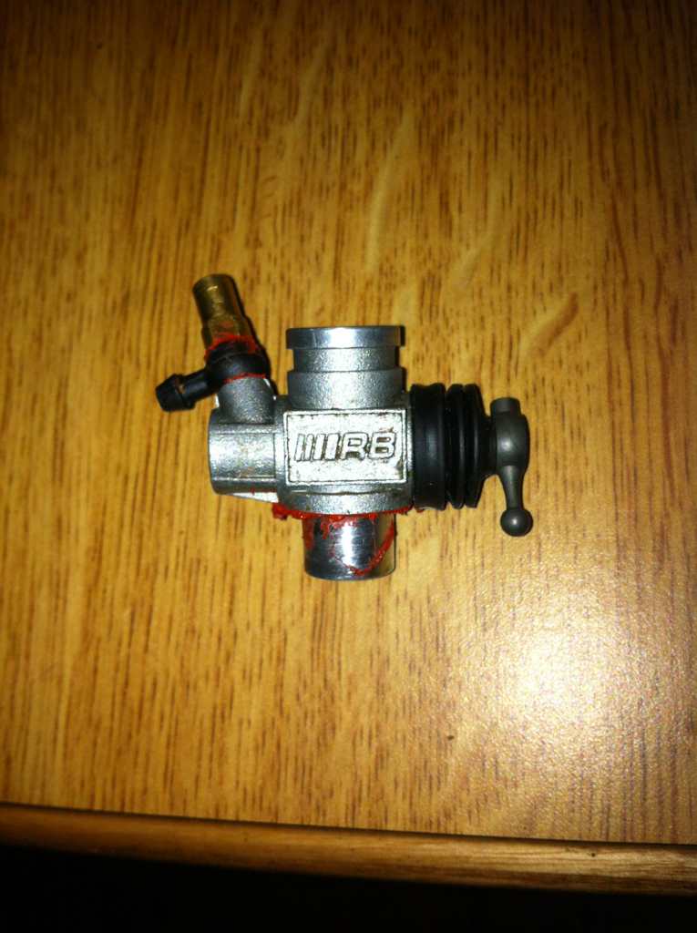

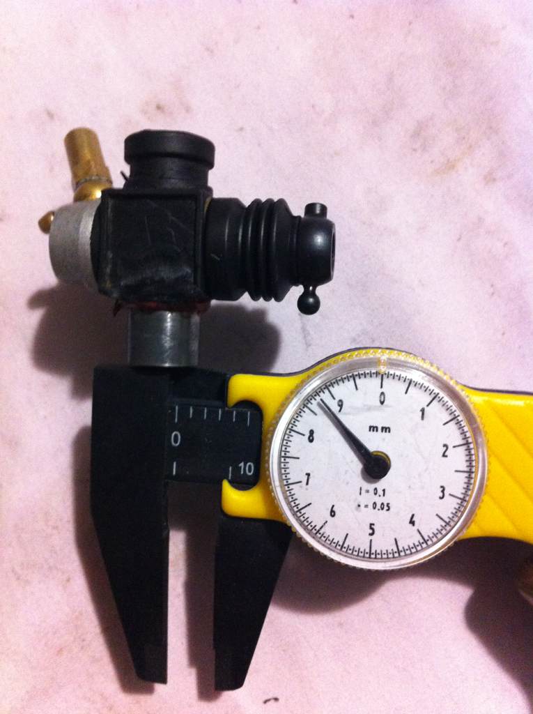

here is an RB novarossie carb I milled it's pretty nice but a tight fit in the revo since its taller
