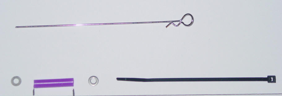

Body clip parts needed

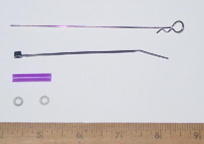

Figure 1: Materials for one pull laid out with ruler for scale.
Procedure for one body clip:
1. Take the fuel tubing and cut one (1) one inch length.
2. Set aside two (2) small washers.
3. Set aside one (1) zip strip.
4. Set aside your body clip.
At this point, you should have something that looks like Figure 1 above.

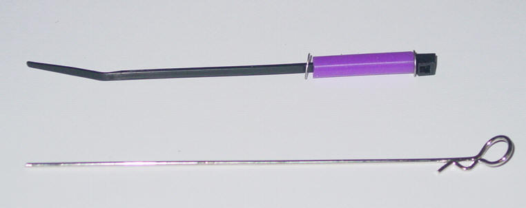

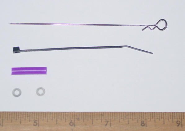

5. Line up a washer, the fuel tubing, and then the other washer. See Figure 2 below.
Measure parts
Figure 2: Ready to assemble the pull.

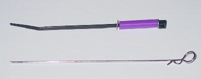

6. Thread the zip strip through the first washer, the length of fuel tubing, and then the second washer. See Figure 3 below.
Threaded zip strip
Figure 3: Threaded zip strip.

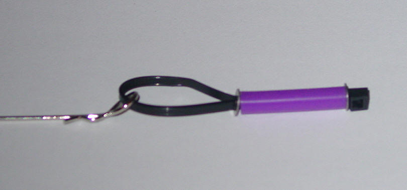

7. Thread the zip strip threw the large eyelet of the body clip and then back through the washer, fuel tubing and washer. See Figure 4 below.
Almost done
Figure 4: Almost done.

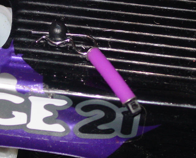

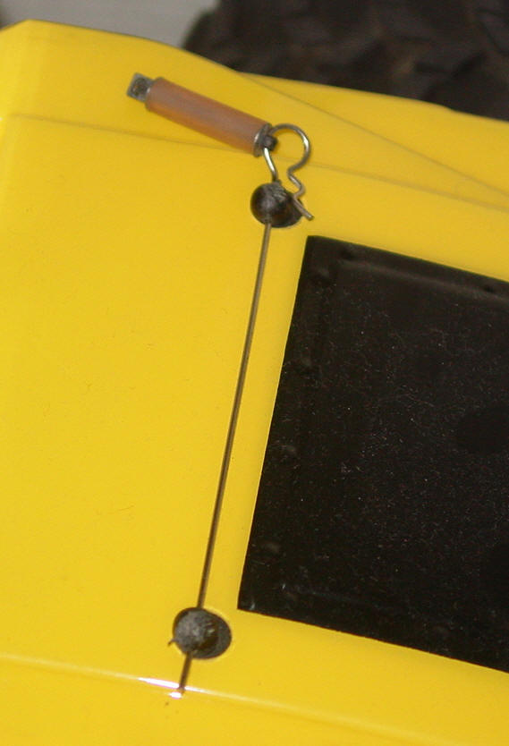

Figure 5: The finished product in place on my Savage and showing the large cross body clip on my T-Maxx.
