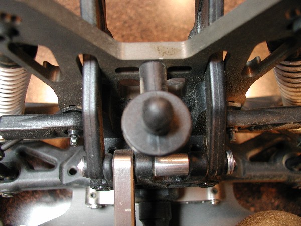

I found that the screw that supports the rear torque brace on my Ofna Hyper 7 PCR Pro is not very strong. After several bash sessions, I noticed that this screw taking a beating…

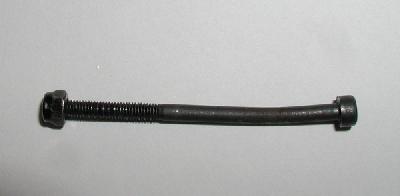

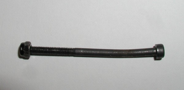

As you can see below, the screw started to bend from the impact of hard landings.
Bent Screw

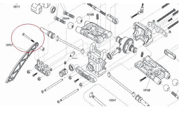

You can replace this screw…

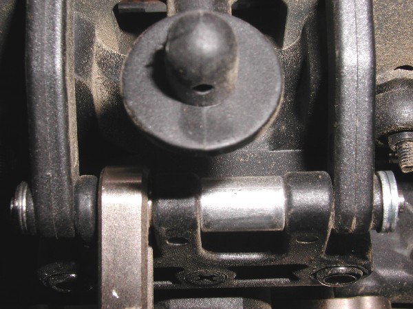

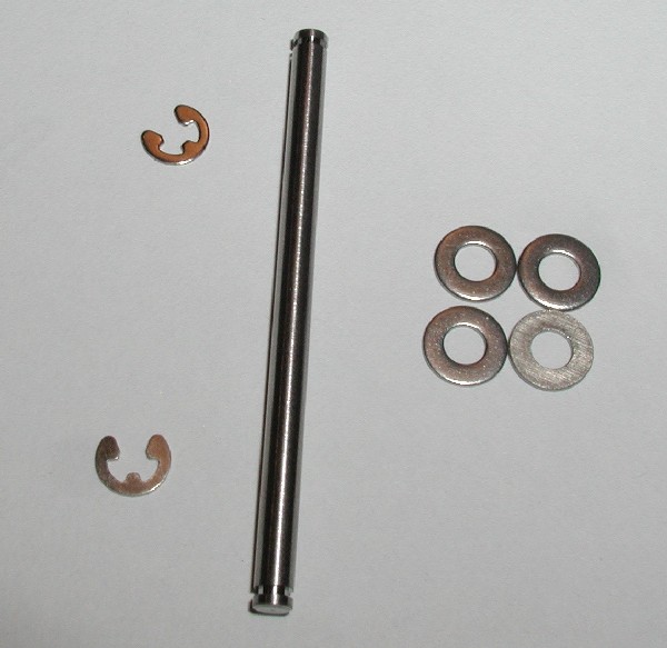

with a Lunsford Titanium Hinge pin, 4 washers & E-clips. (3 x 50mm)
You can find them here…
The result will be a much stronger support for your rear Torque brace…
