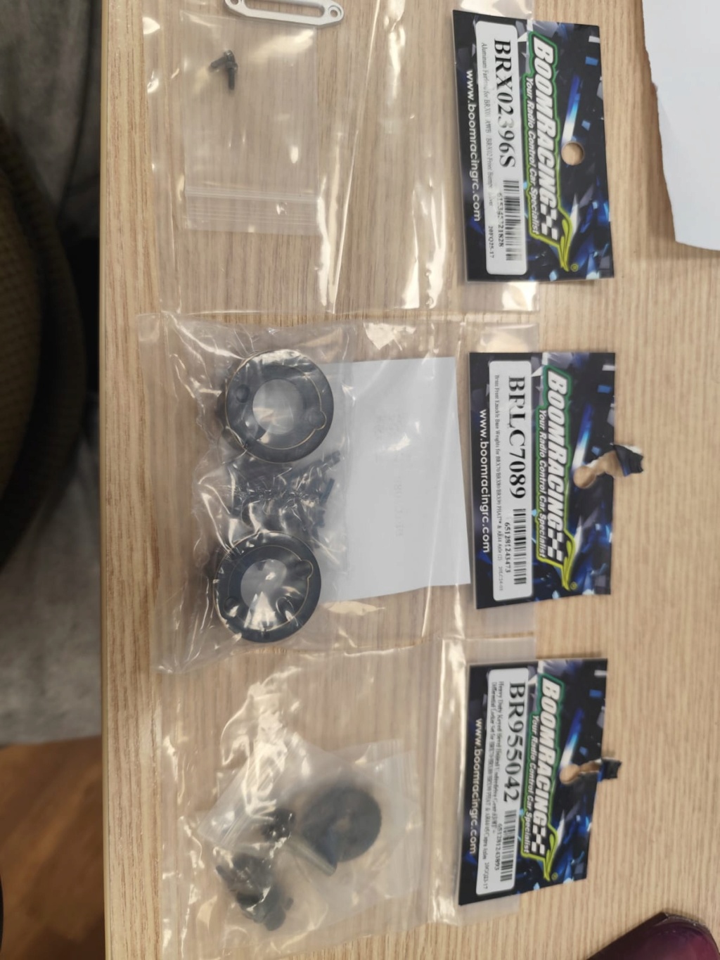

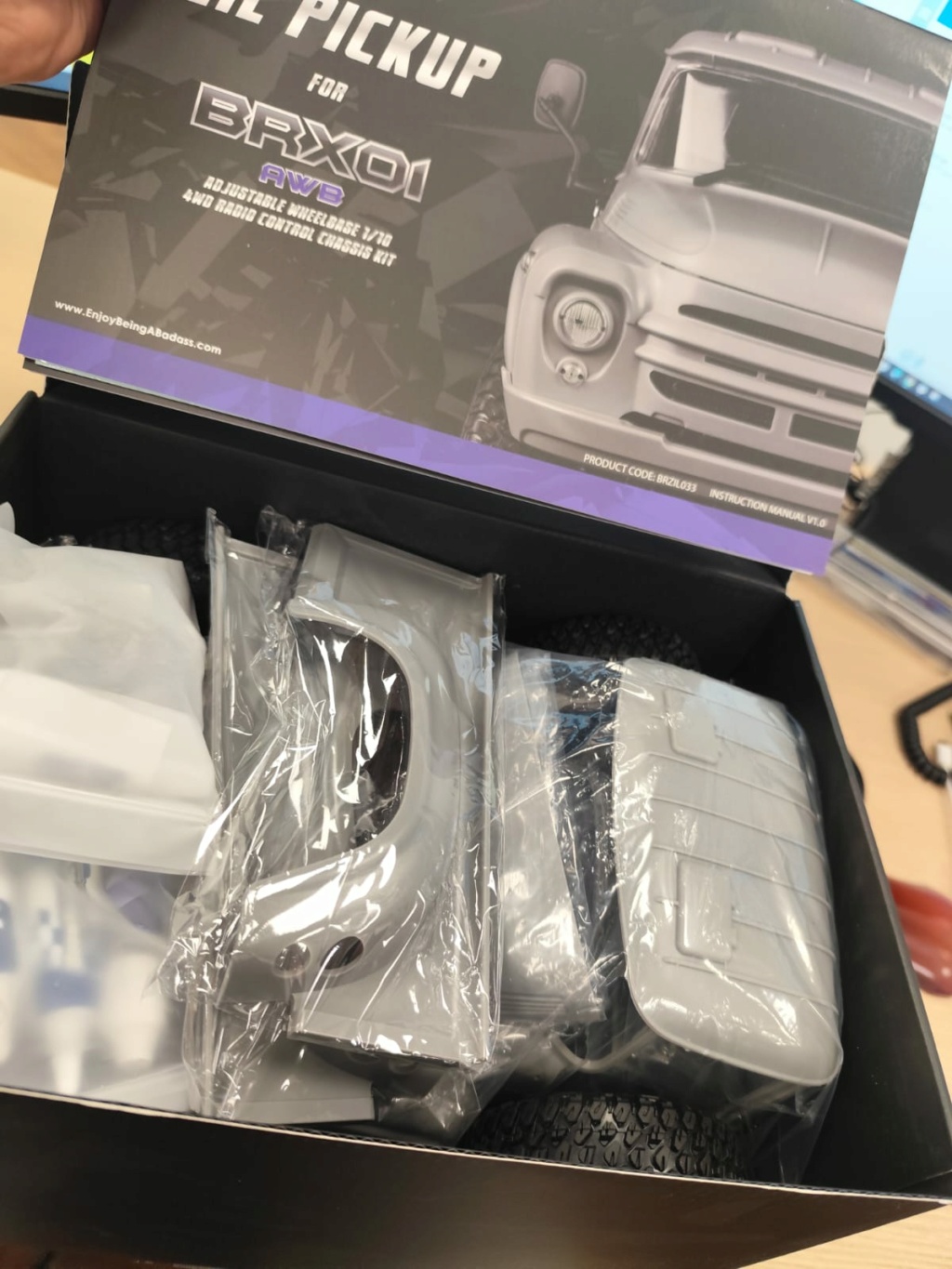

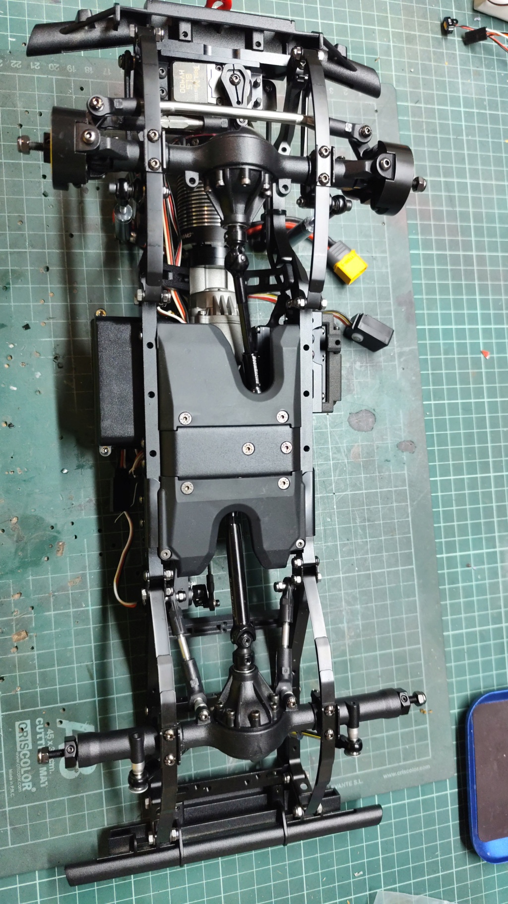

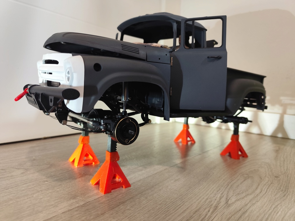

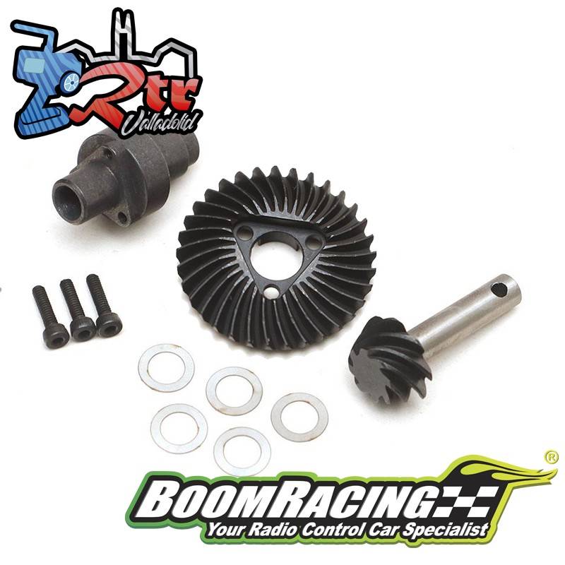

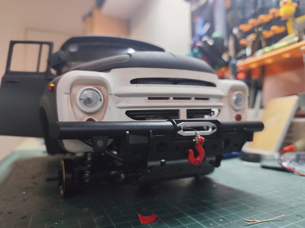

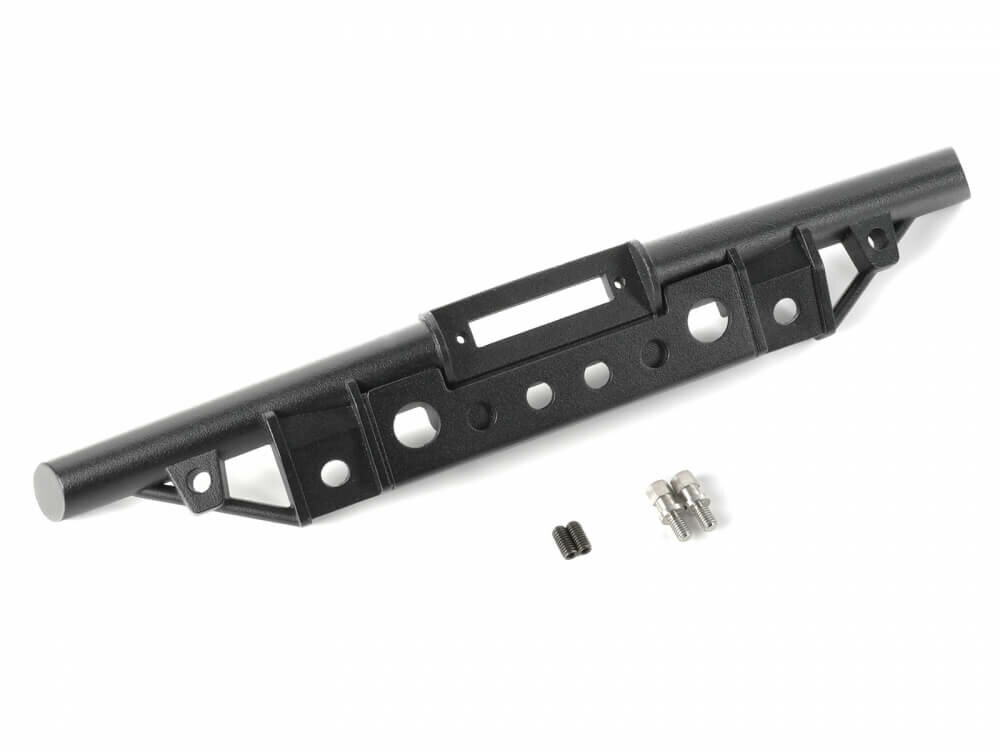

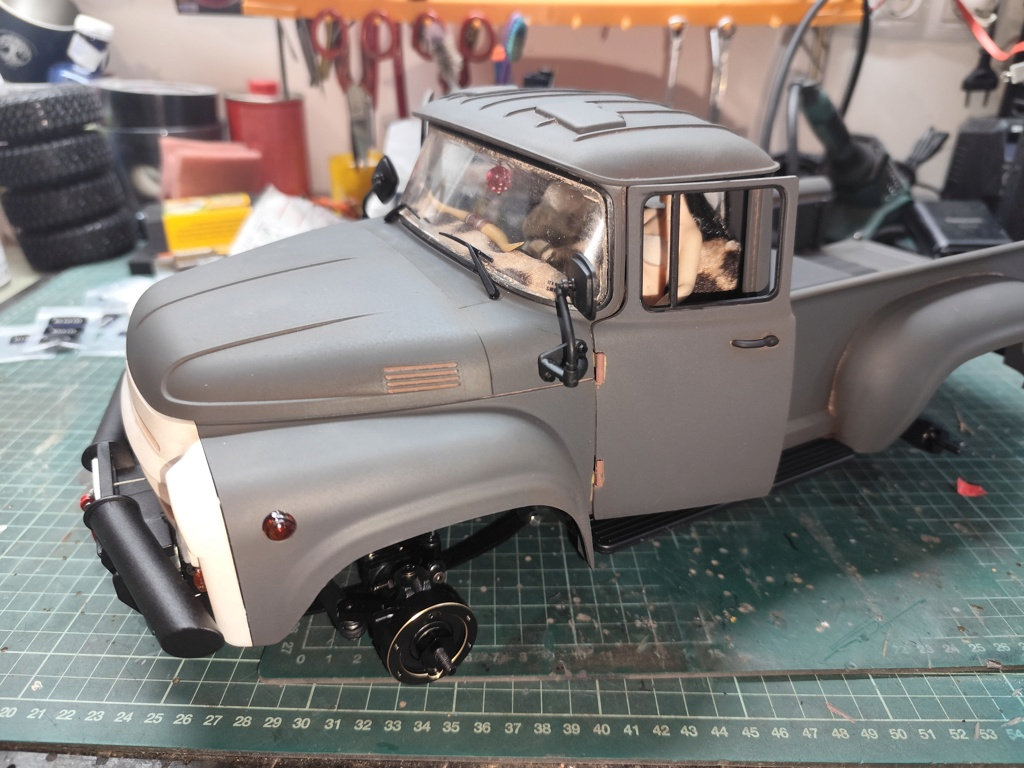

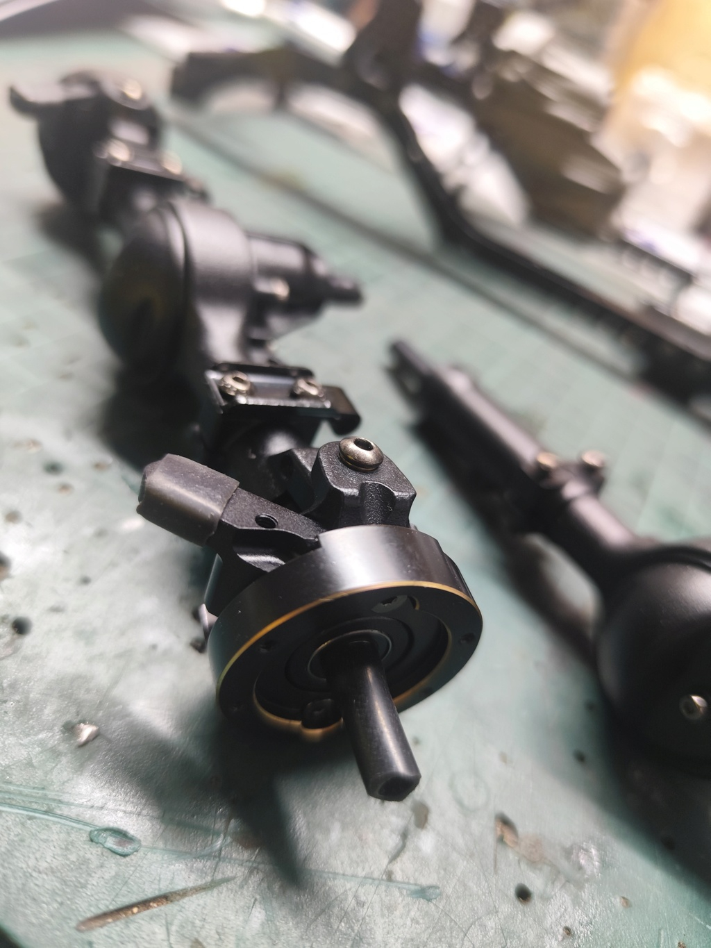

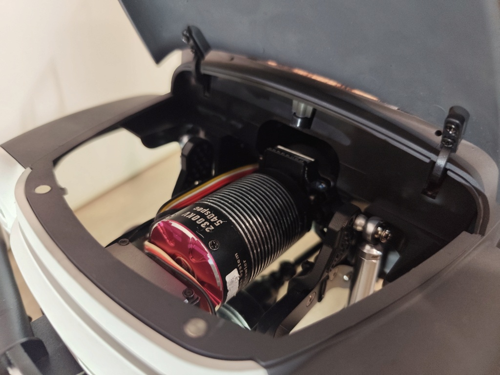

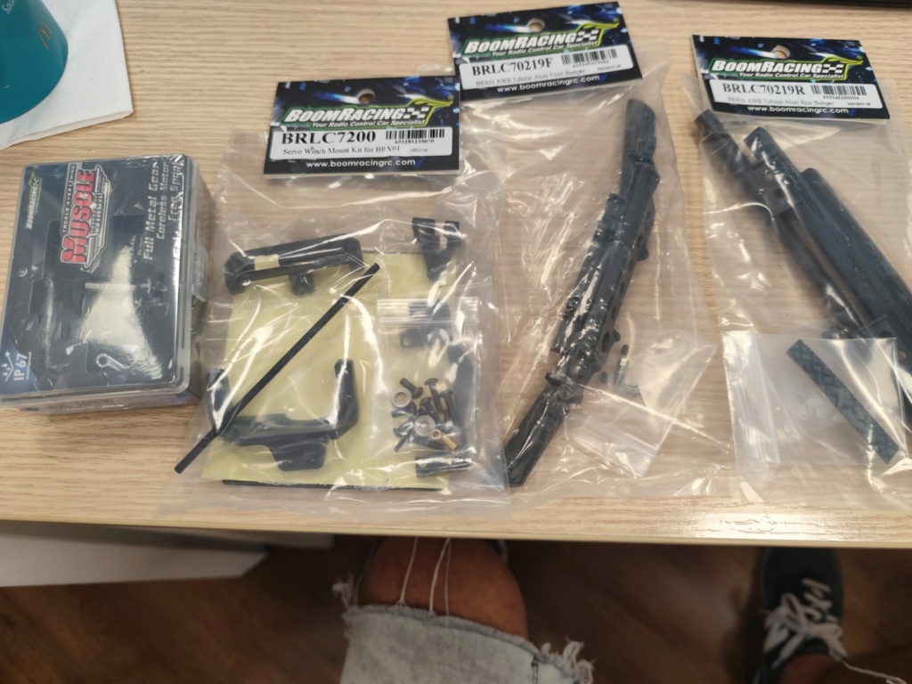

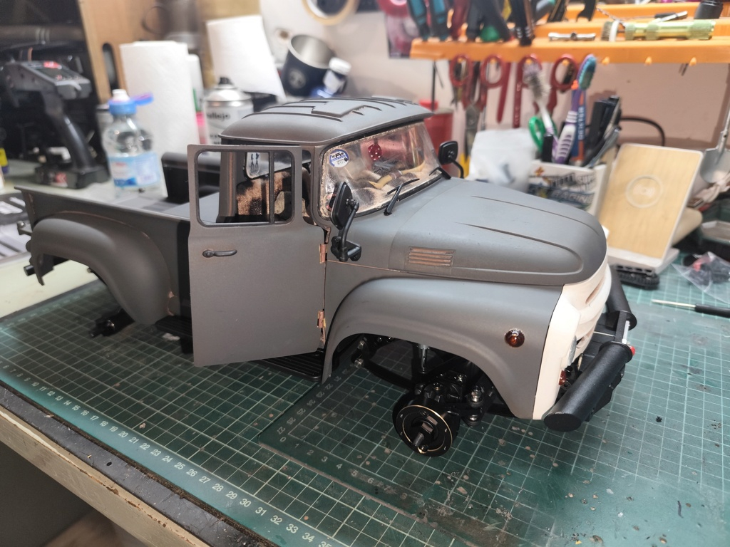

I'm starting a new project, something simple but complete. I have a Fusion 2300 and a Holmes SV400 servo waiting for it, and then the order is for the kit with metal bumpers, underdrive since the 2300 is already powerful, better than putting an overdrive, a brass kit for the front axle, and the complete servo winch kit. I think I'll put in some other rubbers, and that's all for now. We'll see how it's assembled.

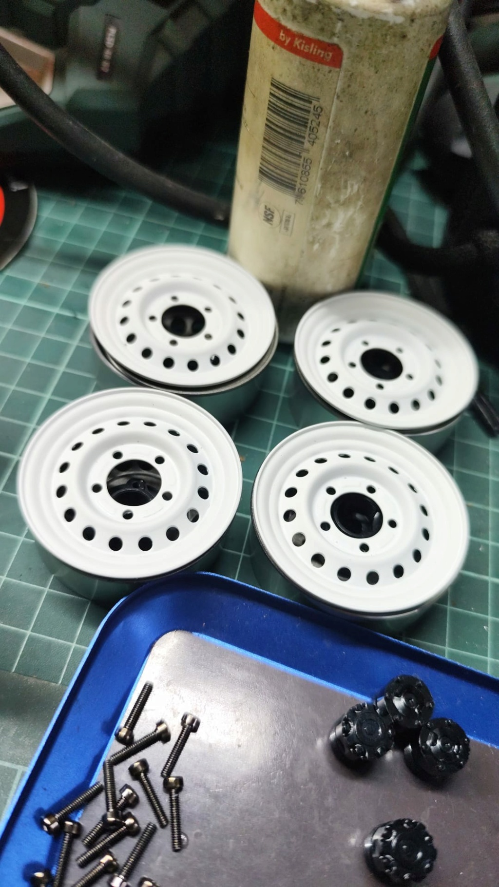

Finally I have also ordered some RC4WD Interco Ground Hawg II 1.55:

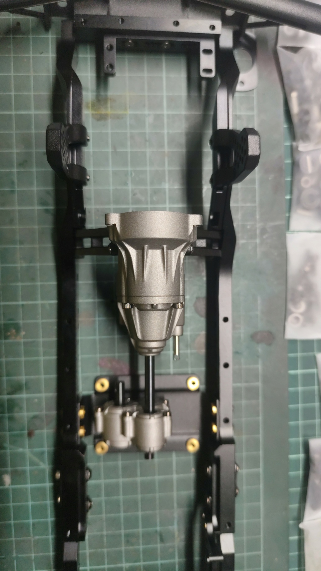

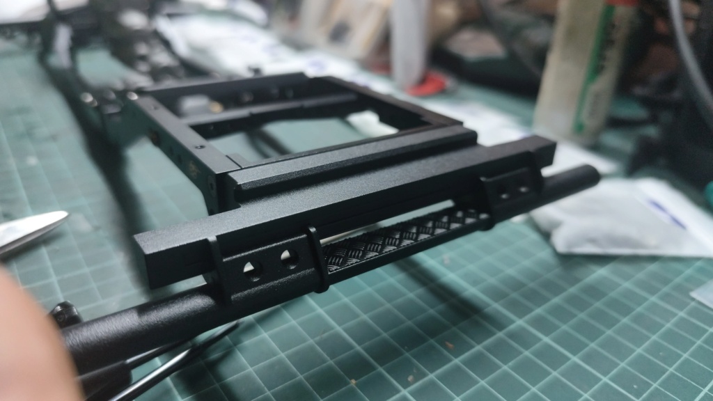

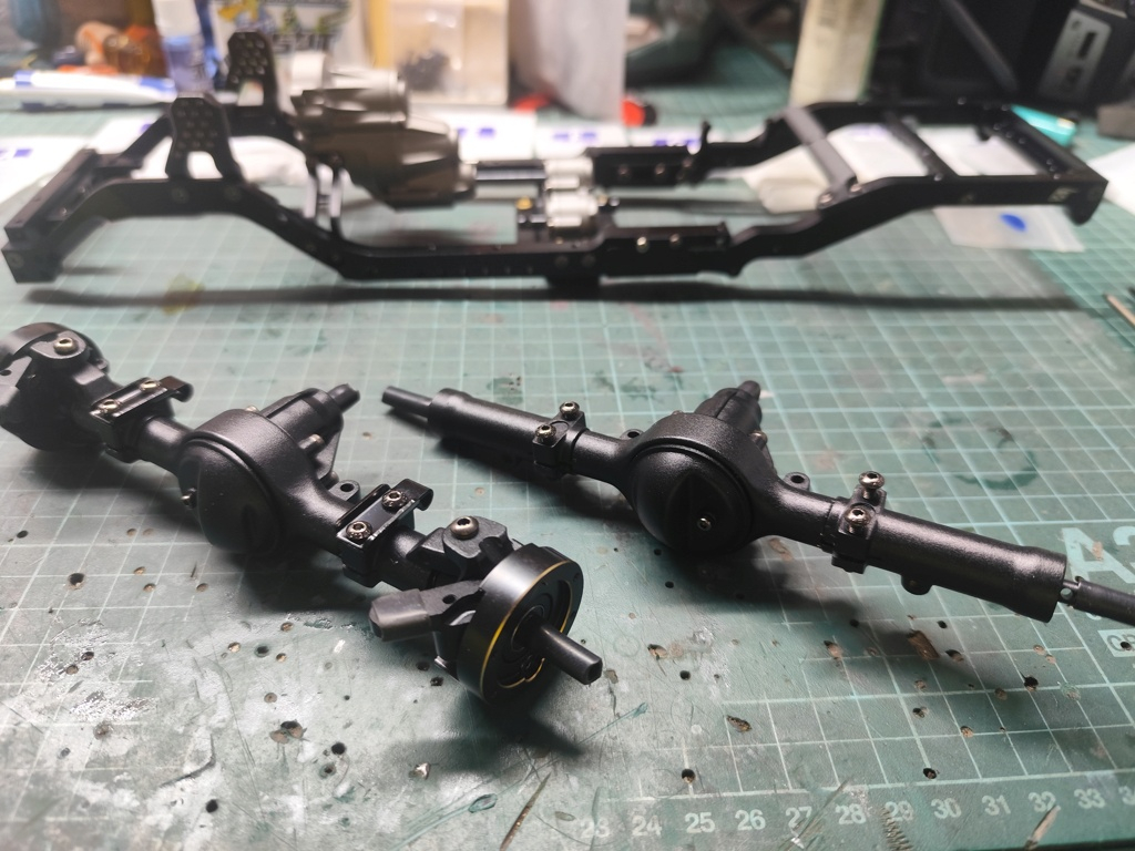

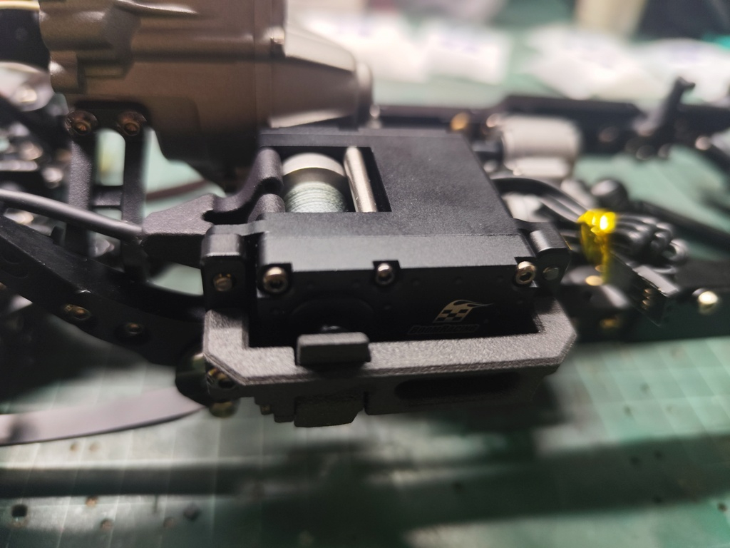

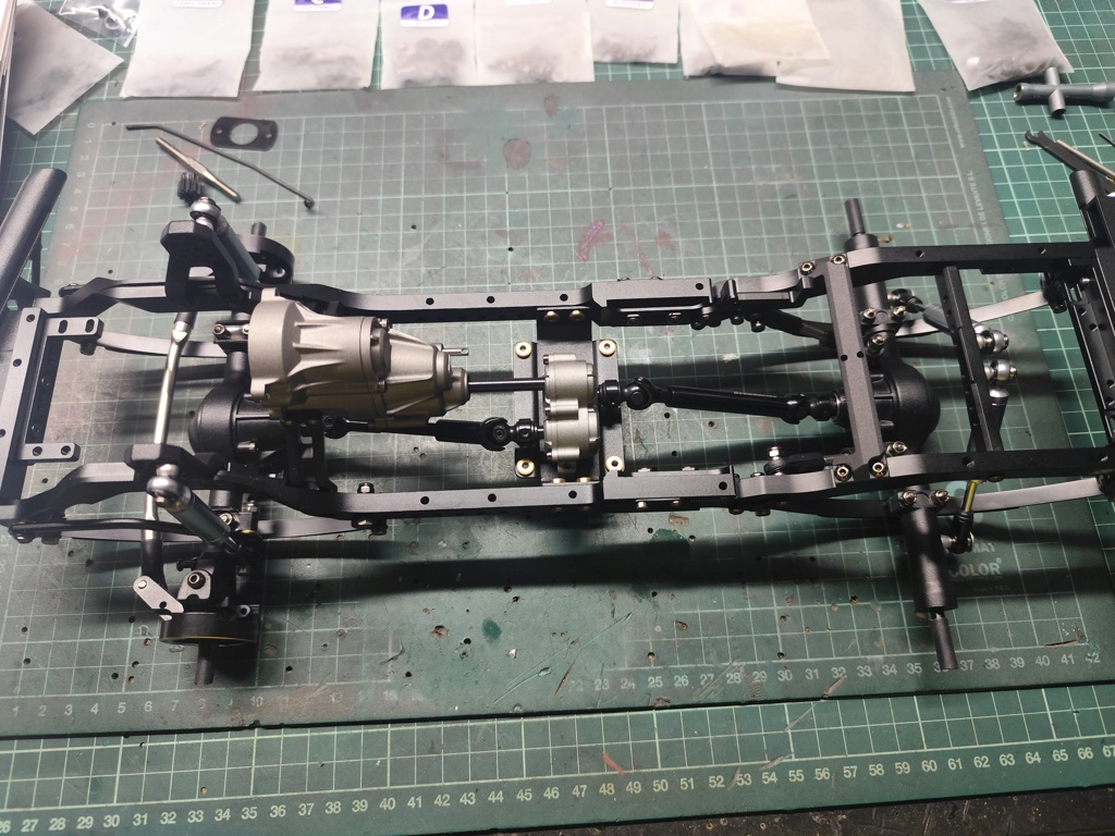

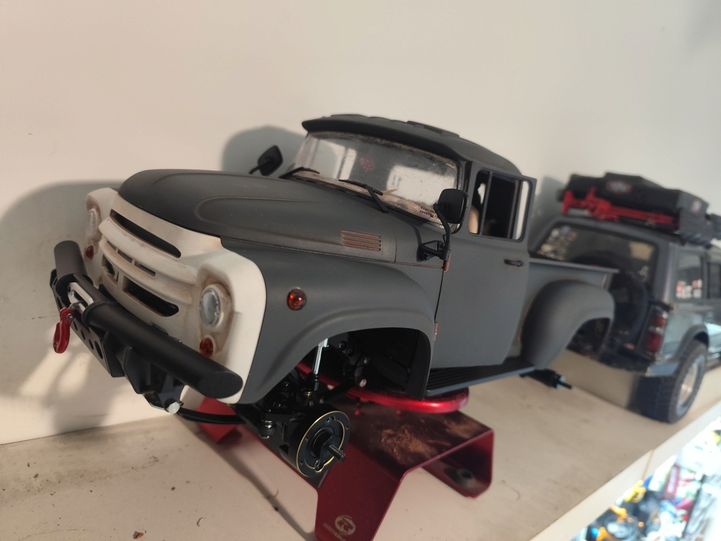

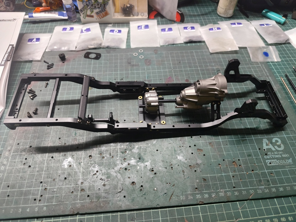

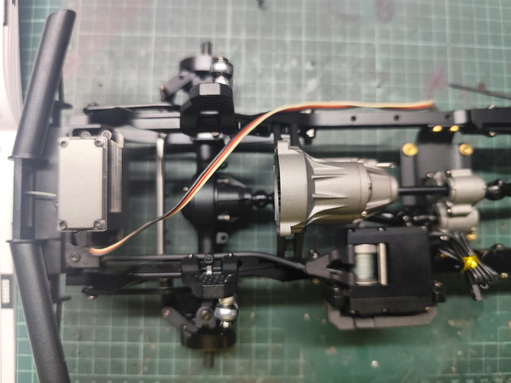

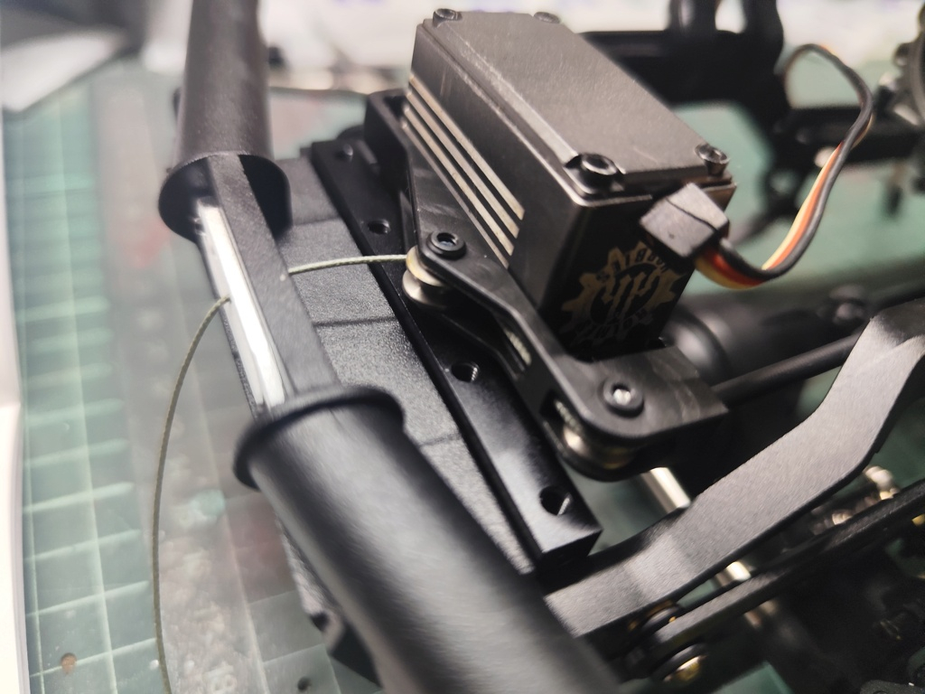

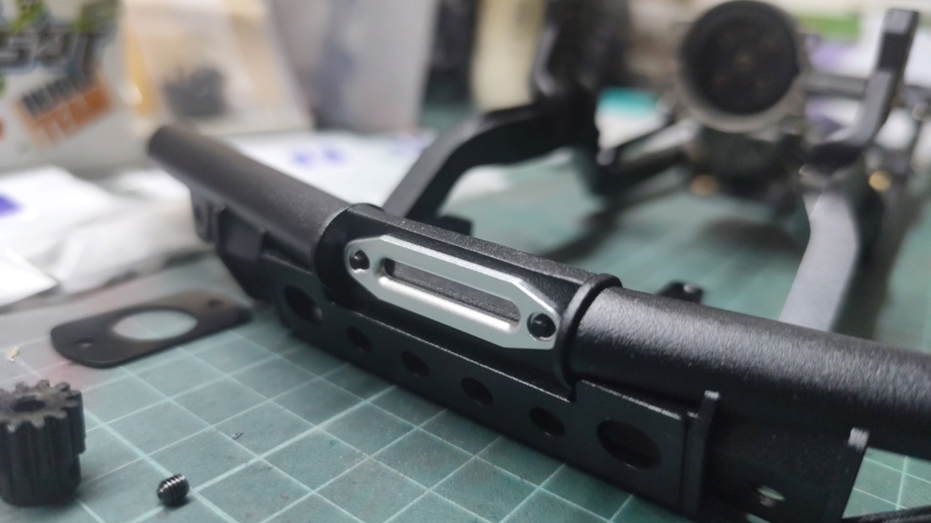

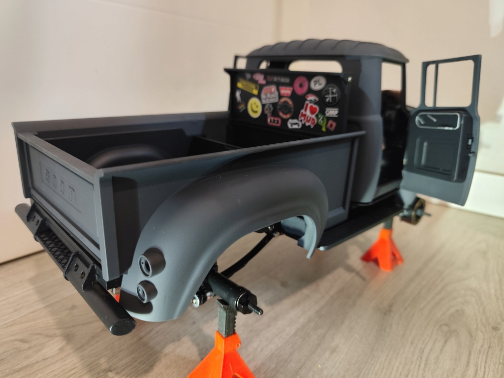

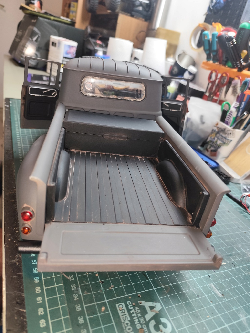

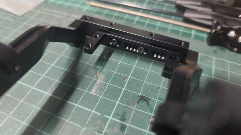

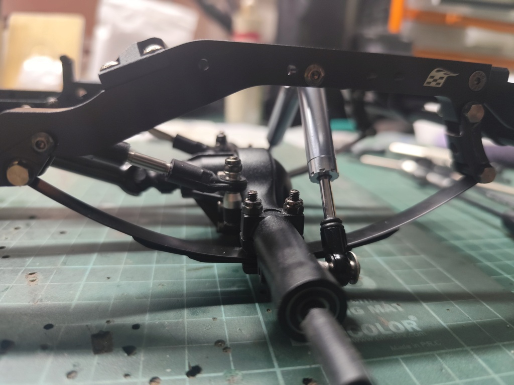

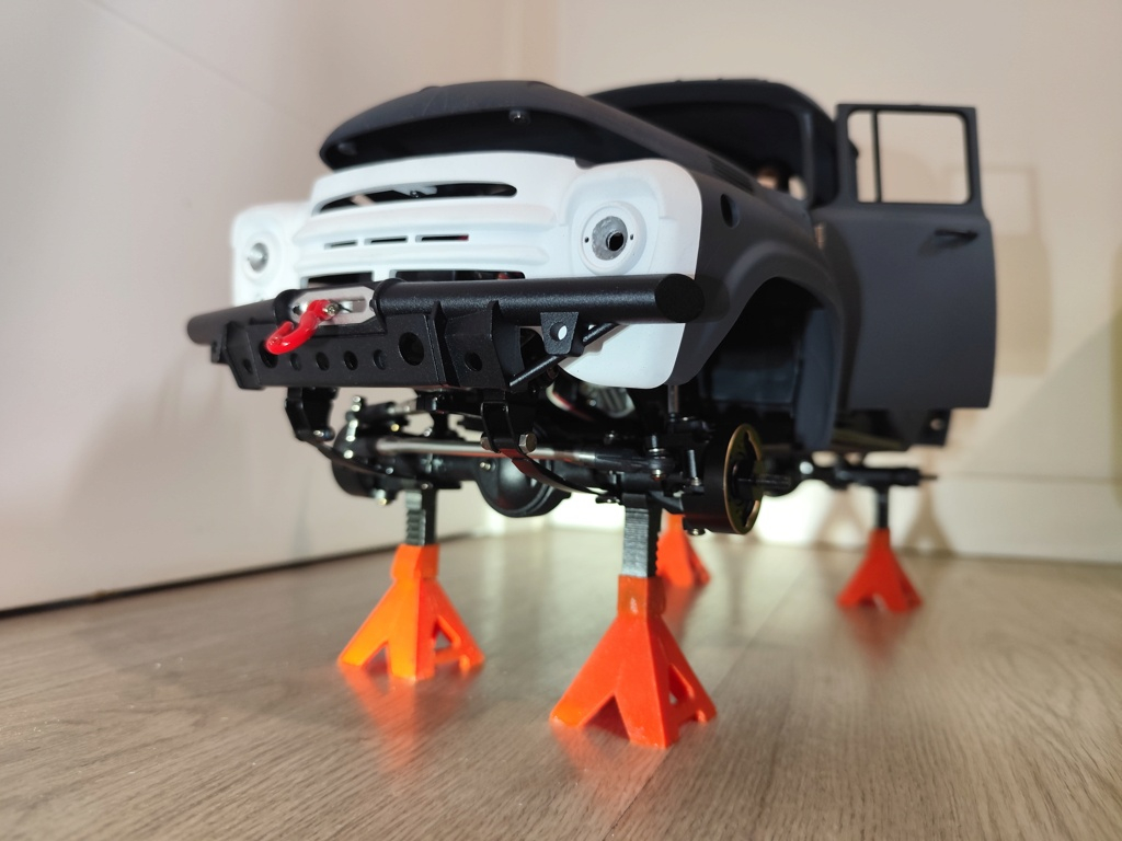

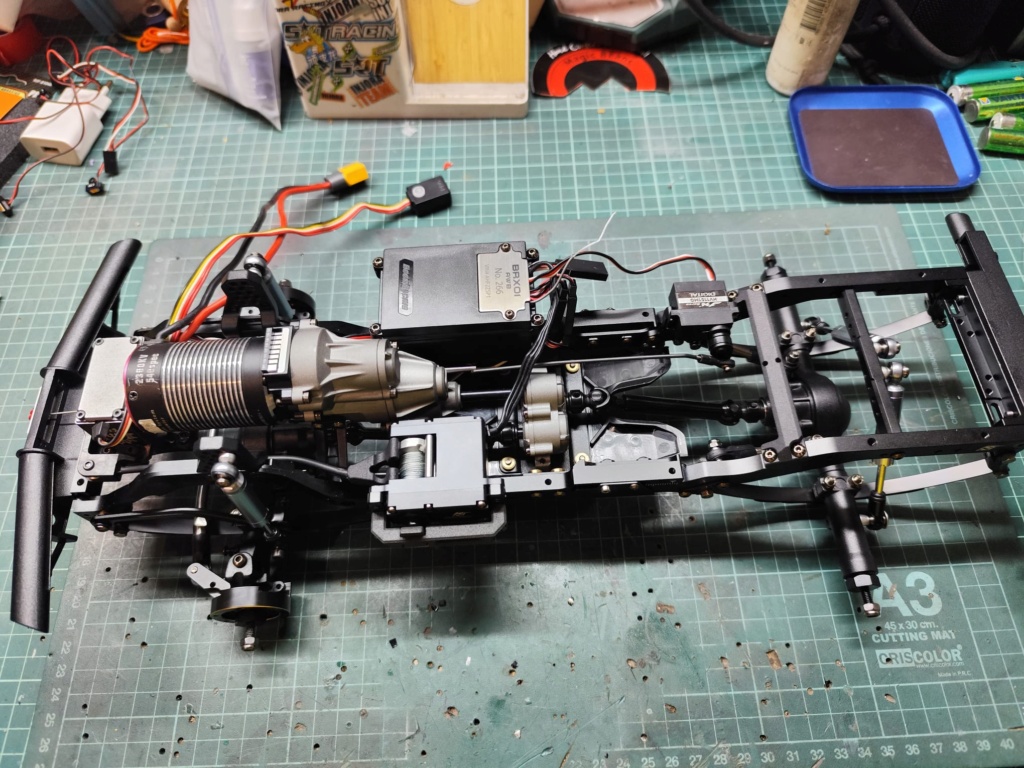

Second pull, it's already taken about 6 hours of work just on the chassis and there's still work to be done, it's amazing, the best leaf spring chassis I've built so far, I love this thing, the winch system is a delight

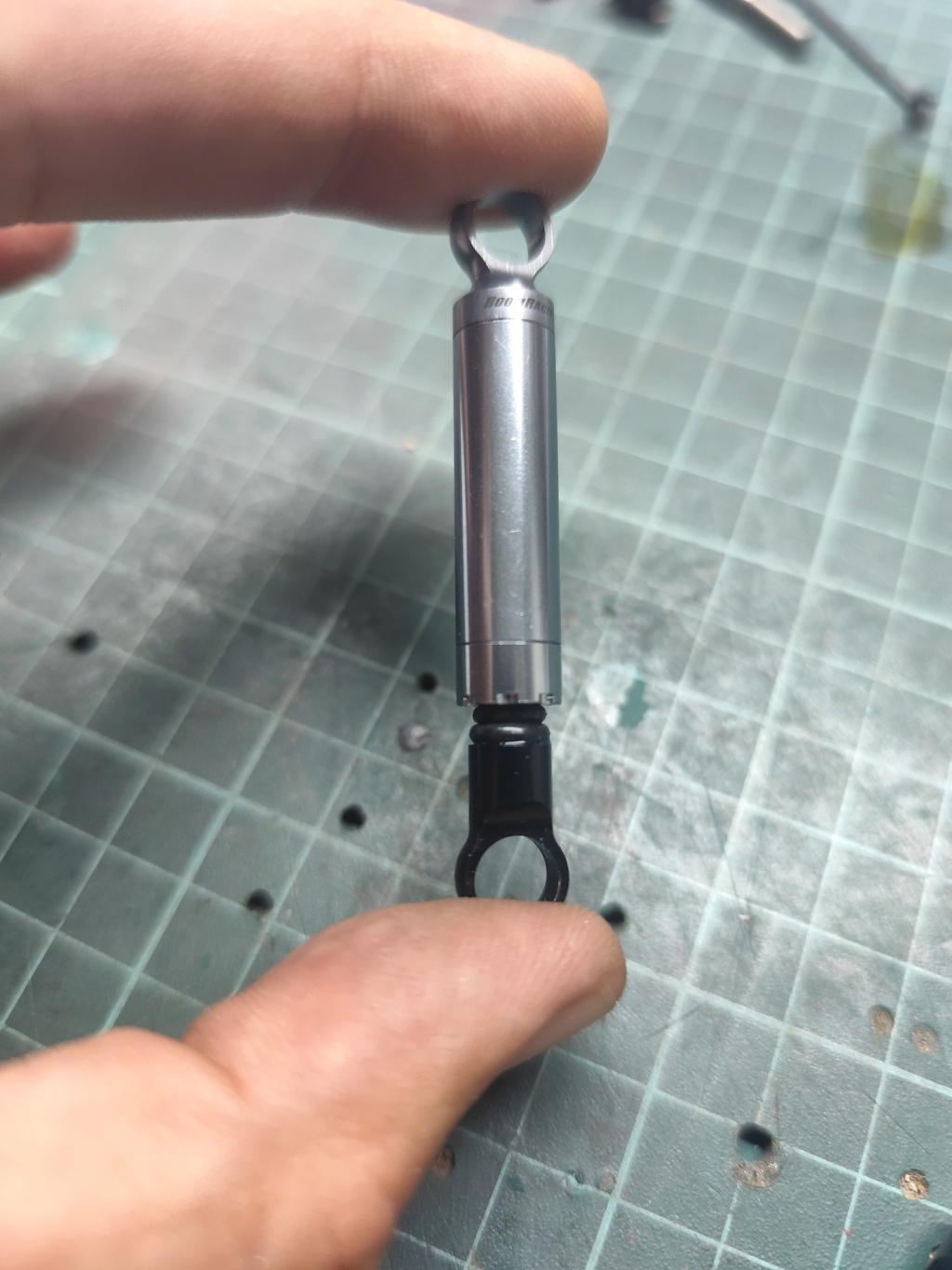

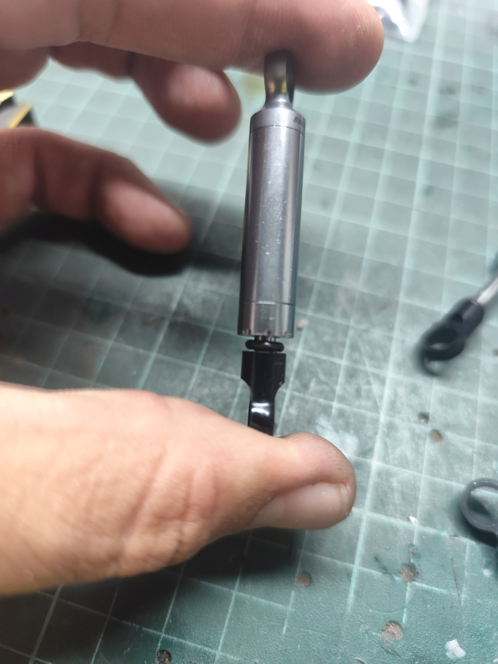

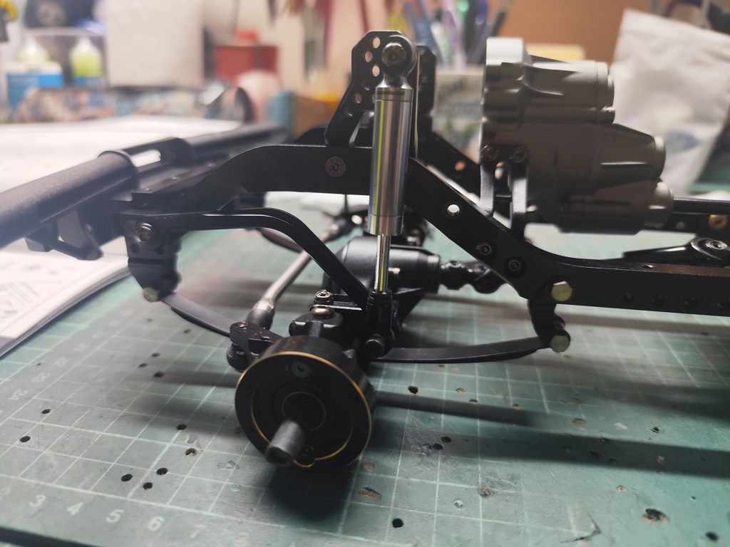

AND Thanks to watching videos and reading before having it, something you might not realize when assembling it is that the shock absorbers come with an O-ring as a stop, but as standard it does not reach the stop, so I added another ring so now it does stop as it should.
This looks like an excellent kit, thanks for sharing/documenting your progress. 👍

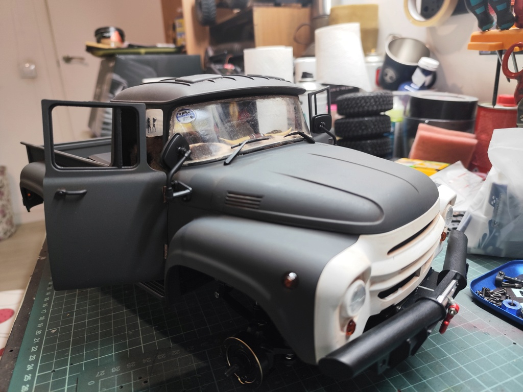

I didn't even know this kit was a thing. Looks like a very fun, very solid build. Absolutely love the body.
this chassis comes with adjustable wheelbase , from 267 to 287 , and from 287 to 301 with option rails , can buy without body & wheels , i think that in 287 with hilux body , its for far , much better than tf2
