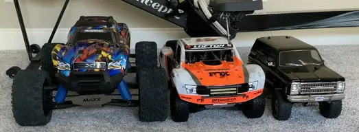

Mid South Hobbies (thank you Hector) diagnosed and fixed my X-Maxx.
The differential needed servicing as 40 runs was a bit too much without maintenance—and yes I’d neglected it after a lot of driving. It wasn’t transferring power at all due to neglect (by me) and simply needed PMCS. Cush drive and gear lash/pinion was fine.
Lesson learned—I’ll start a maintenance schedule similar to what I do with our family cars/trucks.
Good news is X is back in the toy room with her smaller “siblings”, lol.
