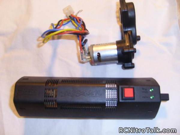

Knowing that some of you are pullstart people, I am looking to get my fingers around a EZ-Start System for REVO 2.5R.
I believe it's the same for 3.3's but not entirely sure :o)
On my used Revo you can hear the teeth grab (spinning engine) and if you let go, next time you may just hear the the little electric motor spin. So I'm looking to replace the whole shabang.

RevoME; Sounds as if you have a dirty one-way bearing. Pull it out and give it a good cleaning and all should be fine.
As your fleet grows you may want some spares ... I have a couple packages you may be interested in.
Mr T
Brand New never used.....
Used, but functional ... with some wiring harnesses in various states.
