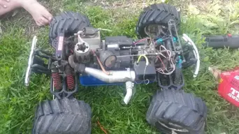

Well here is a before pic for ya. As you can see I have my work cut out for me. Shaun

That's a good looking project there btw. Looks like a early 4910 model 2.5
