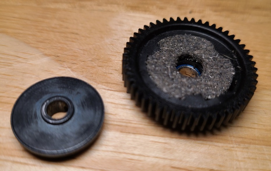

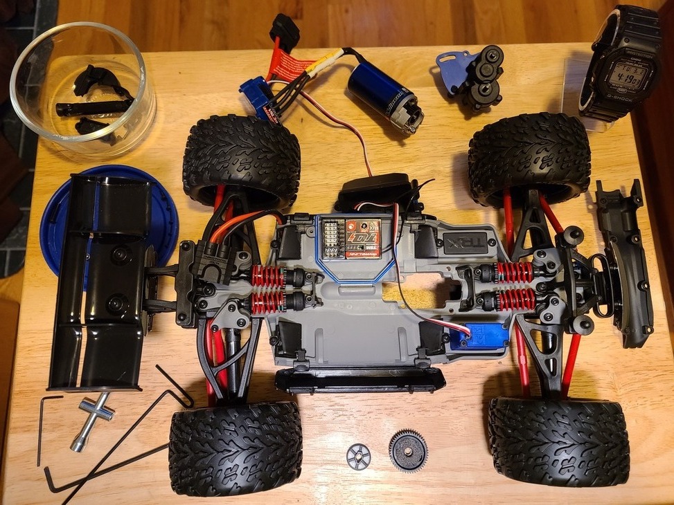

I cranked down on the slipper clutch and it still felt like trans was slipping. I took apart to check if any gears were damaged, all look good. The slipper clutch pad looks worn flush with the gear so no matter how tight you make the spring no force is being exerted between the plate and the pad. Till i order a new pad i've made a temporary backing for the pad. Put everything back together and feels a little better but i think something is still slipping. The gear mesh was good out of the box, now i'm trying to fine tune it to get it good again... :)
