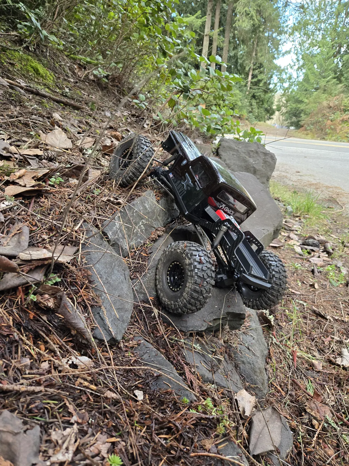

My first comp crawler. SCX10 Pro straight axle.

Recently I have paid closer attention to this for the sake of tuning. More specifically, my rig sags to the left where the battery is mounted.
With a rig that weighs >6 lbs and <6.5 lbs depending on how it’s been set up recently the batteries I run are way more than what I end up using.
Setting: casual trail run with various crawling challenges. Temps cool 45-60F.
Run time 60-80 min
With either a 3s gensacearespammers adventure 2200 or Helios 3700 they run down to storage charge (3.8/cell) at the most.
The next time so need batteries, I will be sizing down.
