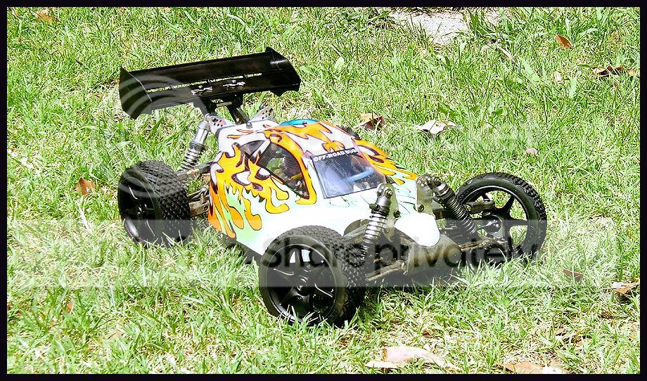

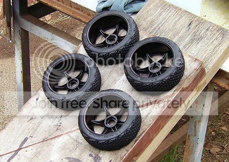

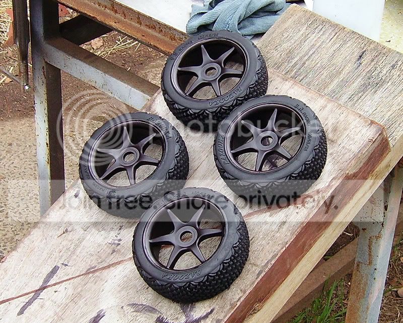

Someone else's pic.
You need to use an old pot or saucepan on the stove(or bbq, etc) and keep it just below boiling temp. It takes around 15-30 minutes, depending on the strength of color you're after. I used an old oven baking dish (shallow) and kept flipping over the rims so I could do 4 rims and 1 wing all at once.
Here is a pic after dyeing the rims and wing. Everything was yellow to begin with.
