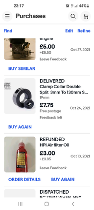

Yea bro iv got the tools they still sell them mate all different broes .these cheep clamps do the same job its the copper ring that goes inside the tool that dose the real work 😁
wait what.. what type of bracket in the workbench clamp is that ? could you perhaps point me to a link of some sorts ? or more info :)
22mm clamps bro 22mm copper cut into a 5mm wide ring as u only want to clamp the top 5mm of the cylinder and a table top clamp heat your cylinder to 100c clamp and quench in cold water test with piston and repeatedly do this till u get a good pinch 👍

If you over titen it u can just reheat and push the piston back in to open her back up mate
