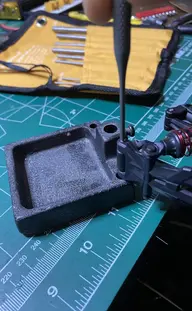

This is probably a newb question but I have a Hosim Q903 with a broken rear knuckle. It's attached at either end with pins. I tried pushing them out with a punch tool but they are really stick in there. Makes me wonder if they are meant to be removed. Is there a trick to this, or a tool maybe?

I ended up using the base of a soldering stand and a punch tool and hammer. The pins are serrated on one end. I assume that's to hold it in place. It's easiest to punch them out in the opposite direction of the serrated end. Unfortunately there's no way to tell which direction that is unless you put them in and remember. I guessed wrong on both pins (Irish curse).
